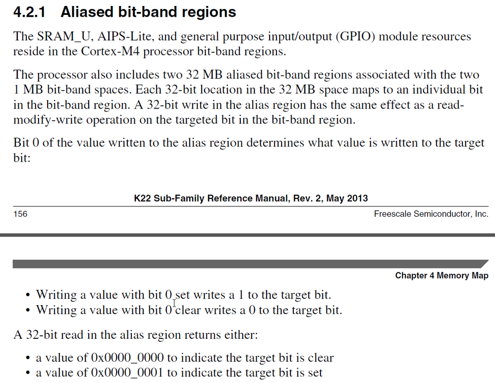

i have a device where i have MK22FX connected to a sdcard with the SDHC periferical and a LCD TFT. I have to read the data image from the sdcard and write this to the LCD that is interfaced with a 8bit parallel port. Every byte write to the TFT need to be validate with a rising edge of a GPIO of write. My question is if it is possible program the eDMA to control also this pin so all the data transfer is done only with the eDMA.

thanks for the reply. So if i want to write high the GPIOD PIN2 for example i have to set:
Reg Register = GPIOD_PDOR is 400F_F0C0h base
Bit Bit = 2
so i have the bitband address, writing 1 on this i will set the bit:
*(calcuate_address) = 0x1U

The LSB is indeed what interacts with the bit-banding hardware.  So yes, to 'set' your bit:
BITBAND_REG(GPIOD_PDOR, 2) = 1;
A particular place where 'bit band' hardware and macro come in VERY handy is to test a Boolean flag bit in a register, and especially for 'write 1 clear' w1c bits in such registers for 'interrupt acknowledge' without RMW or disturbing anything else!

Hi Daniele,
There is a bit-band region allowing user to access the GPIO module, so you may use eDMA to transfer data to this space to control the GPIO pin rise or fall. Please kindly refer to the following for details.

on my kinetis datasheet is written that the bitband GPIO controller address is 0x400F_F000. So my question is, if i want to write a 1 to the GPIOC0 how i have to calculate the address where to write?

Use the BitBand macros in your processor header.
Probably like these:
