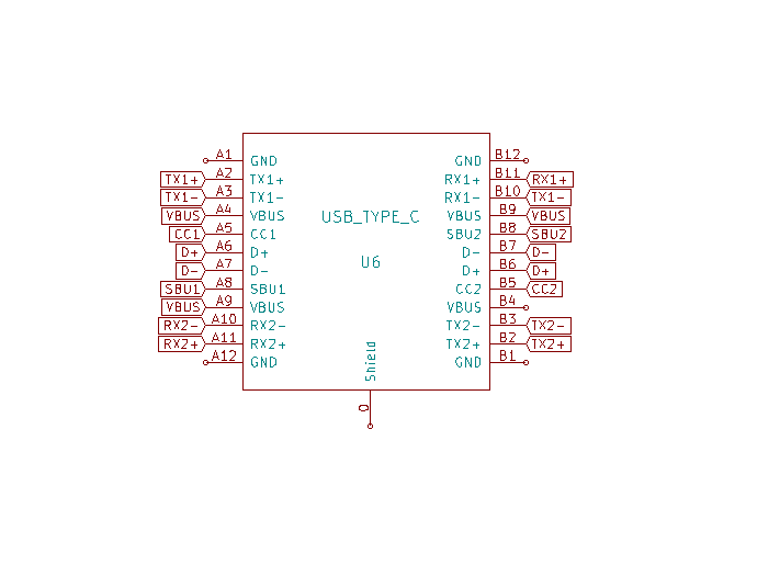

Is there an example of how to connect K2x MCU family to USB Type-C connector with OTG support? I have not found anything.

If you need full USB type C function support, you have use some chip like CC logic for USB Type-C applications|NXP besides Kinetis K2x, but if you just need a USB type C connection, you may connect the signals that K2x USB FS OTG has and leave other unused signals unconnected.
Hope that helps,
Kan

just at a USB type C connection.
Thanks very much.
