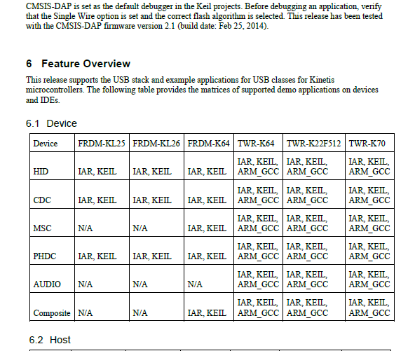

I have 2 questions rearding the Kinetis-L (Specifically the KL25).
1) I have seen multiple examples of the a USB composite devices on the Kinetis-K series, but have not seen any examples of a composite device on the Kinetis-L series.  Specifically, in the USB Stack v5.0 There is a bullet stating that there is a HW endpoint number limitation which causes the msd_cdc example to not work with the HS USB controller.   Also, Table 6.1 regarding Composite Mode Demo’s not being available for the FRDM-KL25 seems to indicate there is no support:
Are there any examples of a USB Composite Device for any of the Kinetis L Series?  Is there some hardware limitiation that prevents composite operation on a KL?
Specifically we are looking to support.  Specifically we need supoport HID (Mouse) and CDC classes.

Just to report back, we were able to get the composite examples running in the KSDK 1.1 with KDS and the new documentation that accompanied it will make it much easier to produce the composite device we need (CDC/HID).

The KL25 has 16 endpoints like the other devices. I use a 3 x USB-CDC<->UART composite device on the KL25 and the only possible restriction is that there is less RAM than the other devices in the table and so the UART buffers may be restriced in size.
In fact the USB code is identical on the KL25 to any other KL or K device apart from about 4 lines configuring its clock, so you should essentially be able to use code from any of the other devices.
The missing configurations in the v5.0 USB stack are presumably because they haven't been tested or the USB stack/demo uses too much RAM for the smaller devices.
