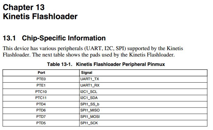

I am laying out a board using the MK02FN128VLH10.  During testing, I want to load my application by using the pre-programmed Kinetis FlashLoader that should be present on the chip.
As I was digging through the documentation, I came across an error in the reference manual, listing the incorrect peripherals for this chip.
K02F Sub-Family Reference Manual
Supports: MK02FN128VLH10, MK02FN128VLF10, MK02FN128VFM10, MK02FN64VLH10, MK02FN64VLF10, MK02FN64VFM10
Document Number: K02P64M100SFARM    Rev. 1, 7/2014
http://cache.freescale.com/files/microcontrollers/doc/ref_manual/K02P64M100SFARM.pdf
On page 239, table 13-1 lists the “Kinetis Flashloader Peripheral Pinmux”
PTE0/PTE1 for the UART1 TX/RX looks fine.

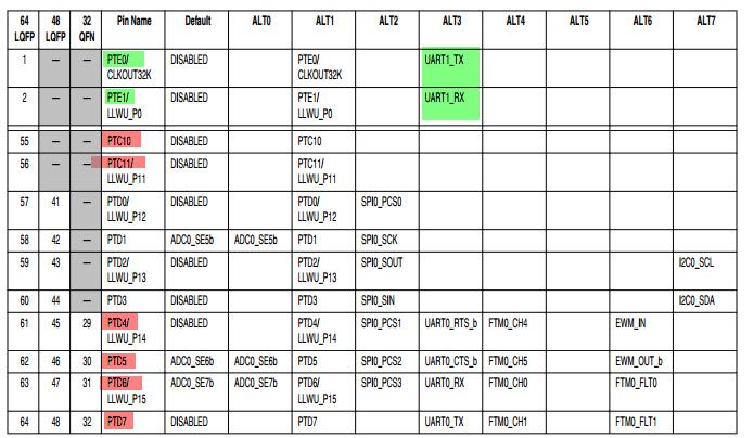

However, this chip family does not have I2C1 nor SPI1.
And the Port C & D pins listed in the table on page 239 don’t have the corresponding I2C or SPI hardware.
(This pinout image  was cut from the table starting on page 178 of the same manual.)
Does anyone know which pins are enabled for SPI and I2C, in the FlashLoader pre-programmed in the factory?

Hi Andy,
As you previously mentioned the Reference Manual is incorrect and we are actively working towards updating that with our Technical Documentation Team.  Many apologies.  The correct pinout should be as follows:
Port        Signal
PTC3        UART1_TX
PTC4        UART1_RX
PTB0        I2C0_SCL
PTB1        I2C0_SDA
PTE16      SPI_PCS0
PTE17      SPI_SCK
PTE18      SPI_SOUT
PTE19      SPI_SIN
Please make your design based on the above pinout.  The signals highlighted in bold are the only signals that will be available at this time as we have also have an errata against the MCU.  The new errata that we will be publishing in the next week or so is listed below.

Thanks for the response, Carlos.
This is exactly what I needed to know, and I can still swap pins around on the schematic, so it is not a big deal.
