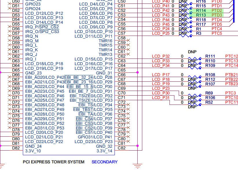

How to setup the clock configuration for uart 2 in TWR K53N512 in IAR,i we have selected the default core clock as 50 Mhz later its calculated in peripheral clock and then that its pushed into uart_init for further processing..
But at the Real term and the tera term are showing the junk value....

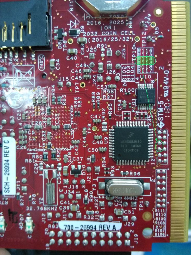

Robin_Shen
Please try to use below pads.
Robin
2,686件の閲覧回数
Hello Binbin,
When you use the UART3, do you connect the UART port of TWR-SER board , the J8 port.
This is link to UART3, while the  UART2 not connected to J8 of TWR-SER .
So if you want to use the UART2, you need connect the pins by yourself .
Alice
