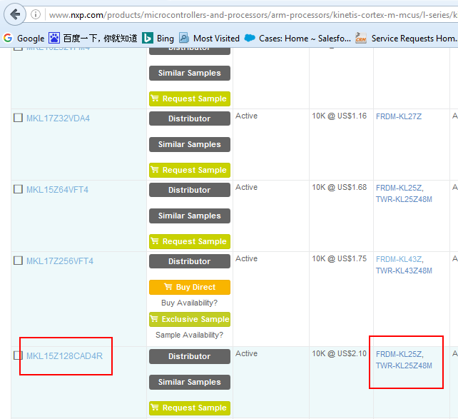

Hello Niko,
Do you meaning download the code about MKL15Z128CAD4R in to the board FRMK-KL25,
yes ,it can .
And when you debug, please configure the debug view to KL25z128 chip .
Hope it helps
