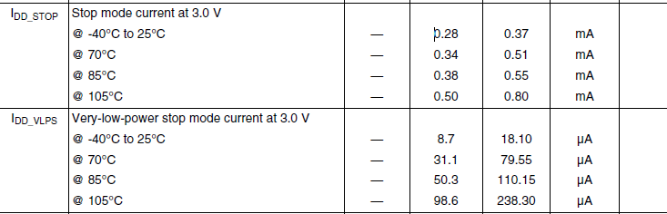

Regardless of this, the problem is related only with the VLPS, as it is taking too much time to wakeup from VLPS to RUN mode, could you try with SMC_SetPowerModeStop (Stop mode), there should be too much difference.
Unfortunately, STOP mode is not allowed by our applications because of power consumption
