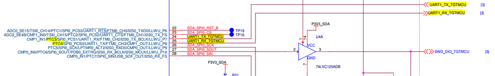

Hello Omar,
In the FRDM-KL26Z schematic​ (I suppose you are using a freedom board) you can see that the OpenSDA UART is routed to the PTC3 and PTC4 pins (UART1).
In the KL26P121M48SF4RM Reference Manual​ pinout you can see that the PTC3 and PTC4 pins are disabled by default. You need to  select the alternative 3 in both cases in the PORTC_PCRx[MUX] register.
Earl Orlando.

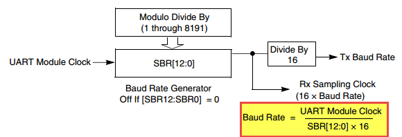

EarlOrlando
Senior Contributor II
Hello Omar,
In the reference manual you can see that the baudrate is generated as follows:
So the SBR value can be calculated:
SBR[12:0] = UART Module Clock / (16 * Baudrate)
The UART Module Clock is the bus clock which does not seem to be configured.
Earl.

Update:
The UART Module Clock is the bus clock which does not seem to be configured. By default the Bus Clock is 20.97152 MHz, so:
SBR = 20.97152 MHz / (16 * 115200) = 11.3777
I suggest to change the bus clock to 48 MHz, it will produce a more accurate baud rate:
SBR = 48 MHz / (16 * 115200) = 26.0416
6,157 Views
omarvallecasas
Hi Earl,
I achieved putting the right Baud Rate and the UART has started to function. Now I'm trying to configure right the I2C0 for FX0S7800 reading. UART will serve to have a feedback.
Thanks so much,
Omar
