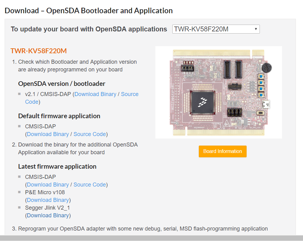

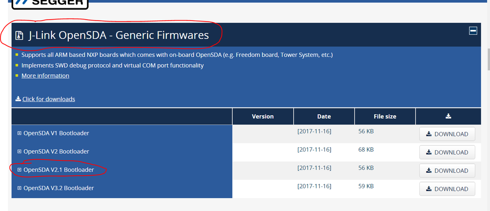

chris_brown
Hi Ravi,
As I said previously, you can get everything you need from other parts of the NXP or third party websites.  For the default OpenSDA applications, you can obtain this from www.nxp.com/opensda.  See the screenshot of this website with the TWR-KV58F220M selected below.
A Segger OpenSDA application specific to the TWR-KV58F220M was never developed.  We have always used the generic Segger OpenSDA application for the TWR-KV58F220M.  See screenshot of their website below.
Also, these packages exist for some legacy boards where that was the original means of providing a quick start.  But we have improved our quick start process and these packages are no longer being produced for newer products.
Chris

tejainece
Thanks for swift response!
Default firmware
The link in the first image is the one that took me the link I posted above, which doesn't work. To be exact, I clicked "Download binary" under "CMSIS-DAP" under "Default firmware application". It takes me to this link which does not work:
https://cache.nxp.com/secured/assets/downloads/en/board-support-packages/TWR-KV58F220M-QSP.zip?__gda...
SEGGER firmware
OpenSDA V2.1 Bootloader shown in second image doesn't work for me when I download it to the TWR-KV58F board. However, the latest image for TWR-KV46FJ works perfectly fine. So I am using this image for TWR-KV58F.
Thanks!
10,134 Views
