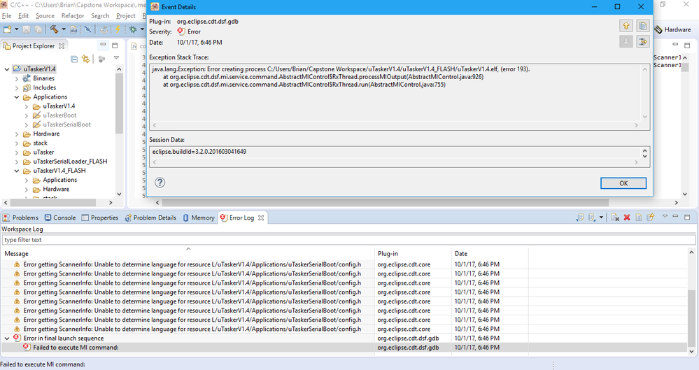

Thank you Mark for all the help. I truly appreciate you taking your time to help me. I now have been able to build and compile the code, but nothing happens(no LED blinks or anything). I have defined BLINKY, but still can't seem to find the problem. Any suggestions? Also, where is the actual code for the blinking LED and what LED exactly is supposed to be blinking? The comment says the "heartbeat LED". The STATUS,TPWR, and PWR LEDs are the only ones on,  I included console window after I compiled the code and configurations that I set up today. Sorry for all the trouble, but I am at a total loss.

So I was able to make the changes that you told me to perform specifically for the TWR-K70F120M, but I am still collecting a few errors. One was a definition error that is being drawn from an inclusion that comes from an else statement that isn't being used so I was thinking of adding the definition to the if statement. When I added the definition to the if statement, it got rid of all errors, but the program would not execute when trying to debug. Thanks for your help.
Error from else statement.

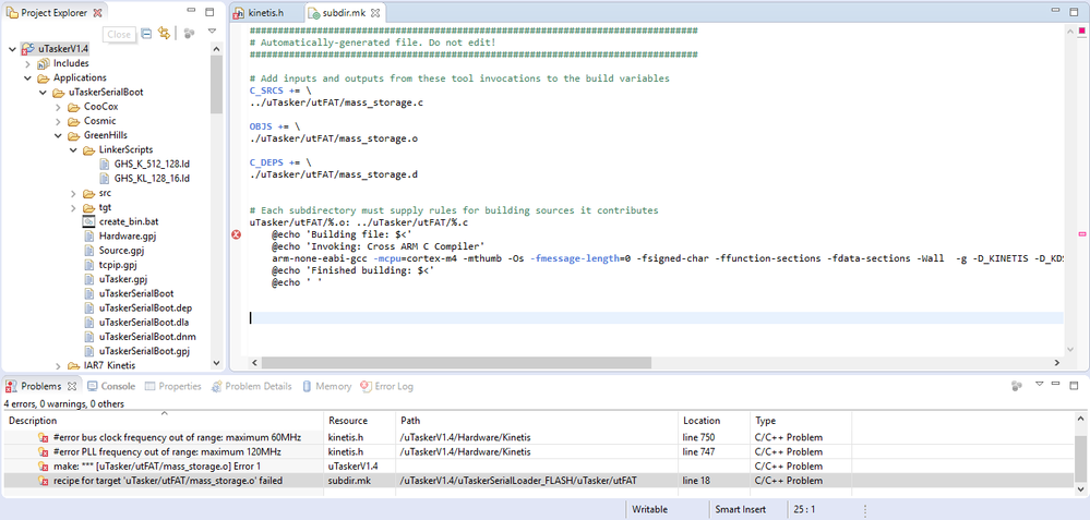

Excute error after adding definition.

I have attached config.h set up for TWR-K70F120M (and simple BLINKY case).
The problem that you had was that NUMBER_I2C was not defined in the Blinky case when I2C was still enabled. The solution was to either disable I2C of add the define. This was not your error since it was like that in the open source version but I just updated it so that the define is never missing.
I didn't see what you changed and can't explain the Eclipse error that you then have.

It is better to show the console window output because it then shows the exact error rather than just the general error category.
However, it is possible that you have set two target boards at the same time - I see that the build is triggering an error because you are building for 60MHz bus clock and the environment sees that the target processor can't operate at this speed. It is generating a build error in preference to the object being generated and then not operating properly on the target (which could cause lots of loss of time if it were the case trying to work out why it doesn't run or is unreliable). Since the TWR-K70F120M can run at 60MHz bus clock I assume that another processor type is being selected (which can happen when two targets are chosen at the same time).
This is how to configure exactly for the TWR-K70F120M in KDS.
1. Import the project
2. In \Applications\uTaskerV1.4\config.h
- select #define BLINKEY to get the simplest project configuration
- disable #define FRDM_K64F (or whatever other board target is selected that you don't want to use)
- enable #define TWR_K70F120M
3. In the KDS build settings choose "cortex-m4" at core. You can also (optionally) select "FP instructions (hard)" and FPU type "fpv4-sp-d16" since this device has FPU (the second is selected automatically when the first is chosen). However, if moving to a cortex-m0+ type later this must 'first' be disabled otherwise a KDS error occurs since it grays out the FPU field and it can't be deselected (and nothing runs).
4. Use the linker script file K_1M_128.ld
5. Build the target "uTasker_V1.4_Flash"
Once you are are happy with the simple case you can remove BLINKY and do more interesting things (USB, SD card, TCP/IP etc.).
