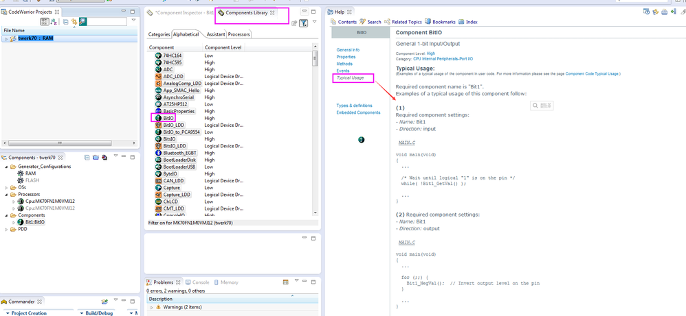

Howdy,
I am pretty new to programming and I have the TWR-K70F120M module. I am trying to start programming but am having trouble learning the system. Does anyone have a simple blink LED code that I can load onto the module, so I can start learning the system.
Alex
1,422 Views
Hello
- There are sample code in website about this board:
TWR-K70F120M|Tower System Board|Kinetis MCUs|NXP

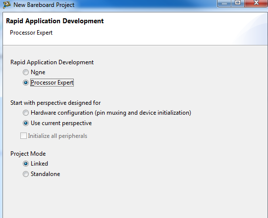

-  Which IDE do you used ?  If CodeWarrior or KDS, you can  also create Processor Expert Project,
it is a great tool for beginner:
then add the Component, for example if you want to LED project, you can add BitIO or GPIO component,
then there will be Typical Usage:
I also attached the Processor Expert user guide for you .
Hope it helps
