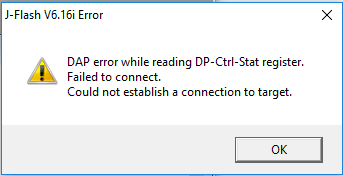

Sorry for the delay. have tried the steps given in Kinetis Lock issue analysis and unlock way.pdf. I see the following error message:
I have tried with J-Flash tool.  My status is unchanged.

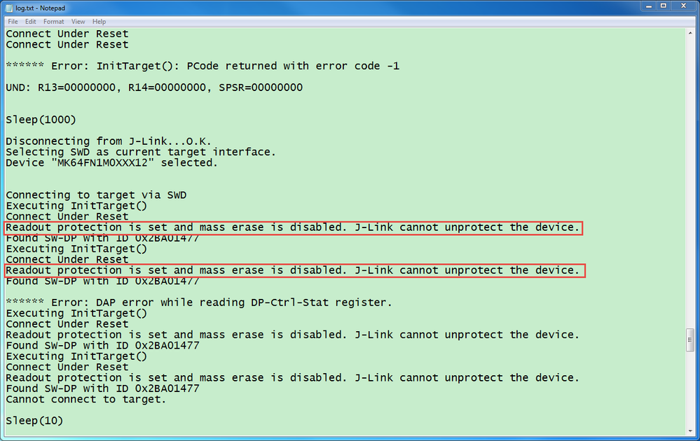

Yes I did, the log file is attached.
6,489 Views
Hui_Ma
Thank you for the log file.
I find below info from log record:
There shows the K64 was locked with mass erase disabled, which was locked  permanently.
The external debugger tool can not unlock that setting of Flash security configuration.
Could you provide the K64 software project's Flash configuration field code for double check? Thanks.

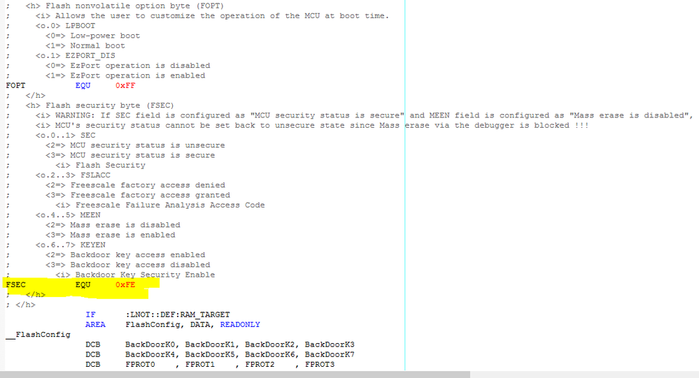

Hui_Ma
I am using the MCUXpresso SDK project as an example:
The Flash configuration filed info located at <startup_MK64F12.s> file with below info:
Or, you also could send us the image file (s19 or bin file).
Ma Hui

csmgsarma
It is the same in my case too!
Hope this helps

Hui_Ma
Hi Sarma,
I think you post the application project Flash configuration file.
For you are using the bootloader at TWR-K64F board, could you provide the Bootloader project's Flash configuration file/Setting?
Ma Hui
6,486 Views
csmgsarma
HI Hui_Ma,
The config file is from Kinetis Bootloader project and not from my application project. Both are same.  If these are not the one, can you specify what is it that you are looking for i.e. file name, location if known.

So far, from the log file, the K64 was locked with mass erase disabled, which means the K64 was locked permanently.

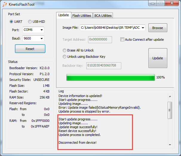

I used your posted [ADC Blinky.rar] includes [Blinky_MQX.hex] with [flashloader_loader] project with below test result:
While using the [Blinky_MQX.s19] image file with [flashloader_loader] project will generate the Error:
Both images could not lock the K64 chip.
