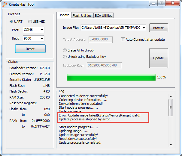

Hui_Ma
Hi Sarma,
I used your posted [ADC Blinky.rar] includes [Blinky_MQX.hex] with [flashloader_loader] project with below test result:
While using the [Blinky_MQX.s19] image file with [flashloader_loader] project will generate the Error:
Both images could not lock the K64 chip.
I could not regenerate your mentioned issue with the FRDM-K64F board.
For customer issue with urgent statues, I would recommend customer to contact with your local NXP distributor.
You could check here to find your local NXP distributor.
Thank you for the attention.
Ma Hui
