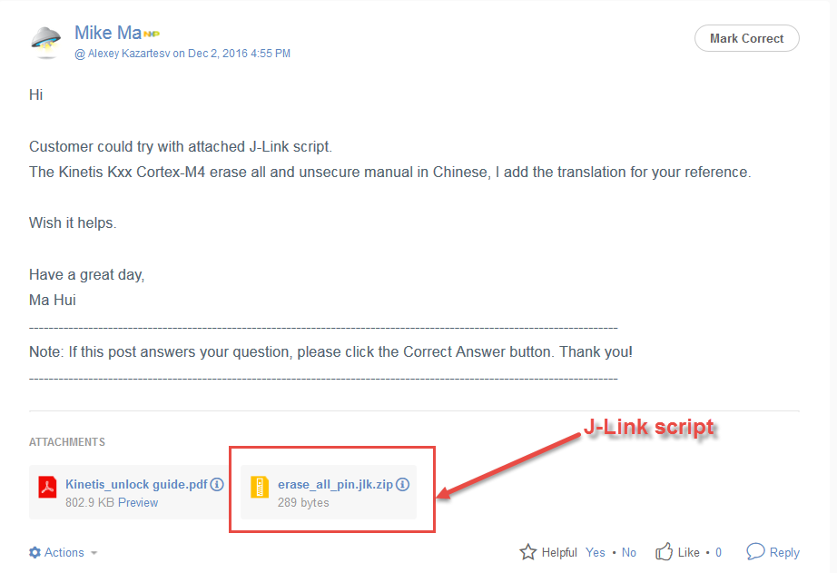

About how to unlock Kinetis project, please check below thread for more detailed info:
https://community.nxp.com/thread/439921?commentID=857127#comment-857127

Hui_Ma
Do you have tried that thread provided J-Link script with J-Link Commander tool?
Ma Hui
