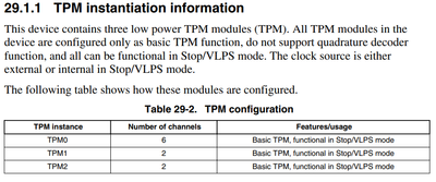

Hi, is it possible to configure the Timer/PWM Module in low power mode (lls)?
If it is, what register is neccessary to configure?
I am actually using MCGIRCLK clock in the SetTPMClock and  kCLOCK_McgInternalRefClk macro in the SetTimerPeriod function.
Thanks.

Hi @GustavoSanchez
The LLS mode is not compatible with the TPM module, it is functional in STOP/VLPS mode.
Let us know if you have another question.

Hi, Miguel thanks for your answer.
And yes I have another question.
Is there another way to use a timer in lls mode? Im not sure if the PIT module have this capability.

Hi @GustavoSanchez
On chapter 7.5 Module operation in Low-Power modes on your KL17 reference manual, you will find a table that says the functionality of your board modules in different power-modes. Based on the tables LLS section, the PIT module stay static (Module Registers states and associated memories are retained).
Let me know if you have another question.
