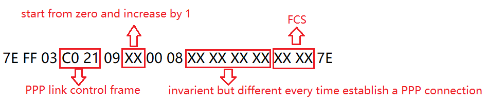

I create a PPP connection over serial,but after connection,the serial will receive 16 bytes data every second as the picture below .Is it a normal phenomenon?Can I send something to cancel this?

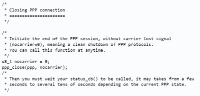

I've encountered another issue:
①I have set a Timer by calling xTinerCreate to judge if PPP is connected within 15 seconds.If not,I will call ppp_link_terminated to terminate the connection.
But after that the fsm_timeout is not canceled which may call pppos_write eventually to continue to request the connection.
②if a PPP connection is established,now I want to disconnect it,I call ppp_link_terminated.But a few seconds later,a hardfault occurs when executing pppos->output_cb in pppos_output_last.
I don't know what's the correct disconnection scheme.I think if a connection is closed,all relevant timers should be canceled.

the 16 bytes frame will go to the function "lcp_extcode" case `ECHOREQ` and the 16 bytes frame will echo back to the peer.
I find two links about it:
https://www.eit.lth.se/ppplab/PPPdocs/PPPLCPoverview.htm
https://www.freesoft.org/CIE/RFC/1661/28.htm
It seems the peer device send the ECHO-REQUEST every second to check the connection.Does it mean the ralative setting to cancel this is in 4G module side?

Could you please try with ppp_close() or pppapi_close() to terminate your connection?
Also, please check it out the lwIP: PPP information, there you may find content of how to do a PPP connection. It may come in handy.

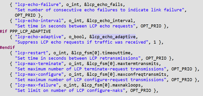

Related with the frame behavior you got the PPP LCP code as 09, that means someone is doing an Echo-Request that provides a loopback mechanism to check what are the other side doing at the moment.
Please check the file lwip->src->netif->ppp->lcp.c and the LCP-related command-line options. There could be something useful for your issue.
[Function static option_t lcp_option_list[]]
