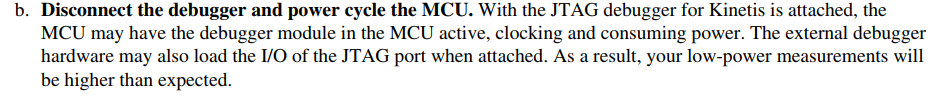

The external debugger connection will affect the Kinetis chip enter into a pseudo low power mode.
Please check here for more detailed info.
The AN4503 shows some tips about making low-power measurements on the bench:
In general, when we check if the chip enter into very low power mode, we will measure the chip current match with datasheet spec and disconnect external debugger at first.

Thanks a lot for investigating!  I'm using Segger J-link probe directly attached to the K27F/K28F through the Cortex connector (I have modified FRDM-K28 in order to do this). When running the application from the debugger, the STOPA bit is always set when exiting stop mode.  When I removed the j-link probe / debugger it works as expected. So I guess the debugger attached prevents it from going into deepsleep/stop mode. I verified this using some printf's as you did. Thanks again for you help.
