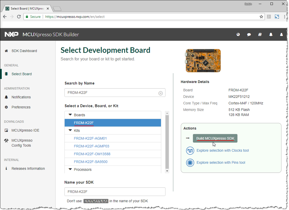

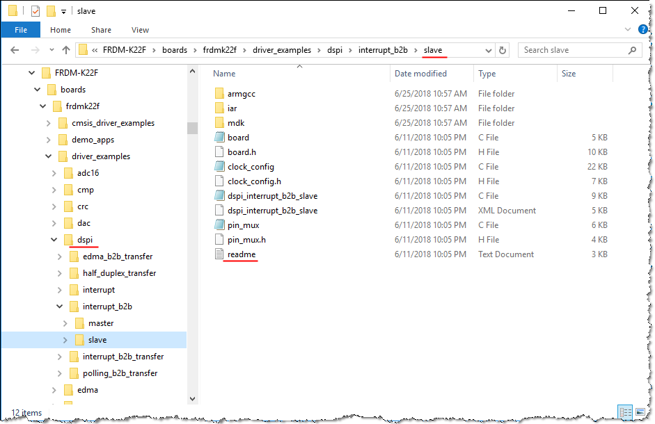

Hi simonbour,
Please download the latest MCUXpresso SDK_2.4.0 FRDM-K22F, then you will find several dspi slave examples.(...\FRDM-K22F\boards\frdmk22f\driver_examples\dspi)

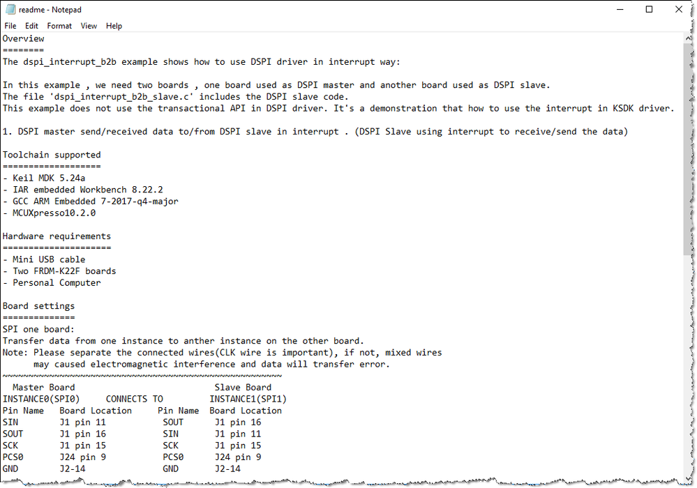

If you have two FRDM-K22F boards, you can direct test them.
The readme file will show you how to test these examples.

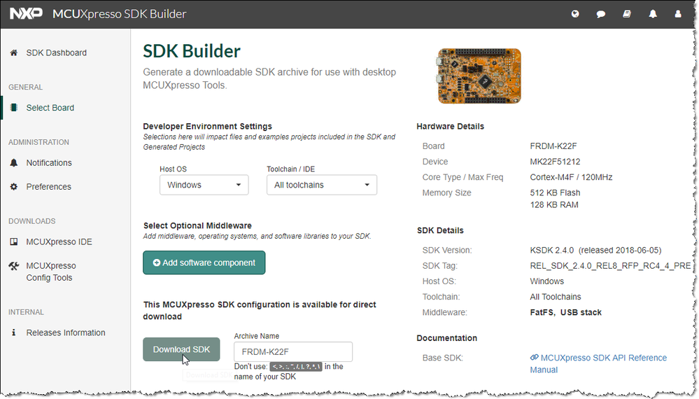

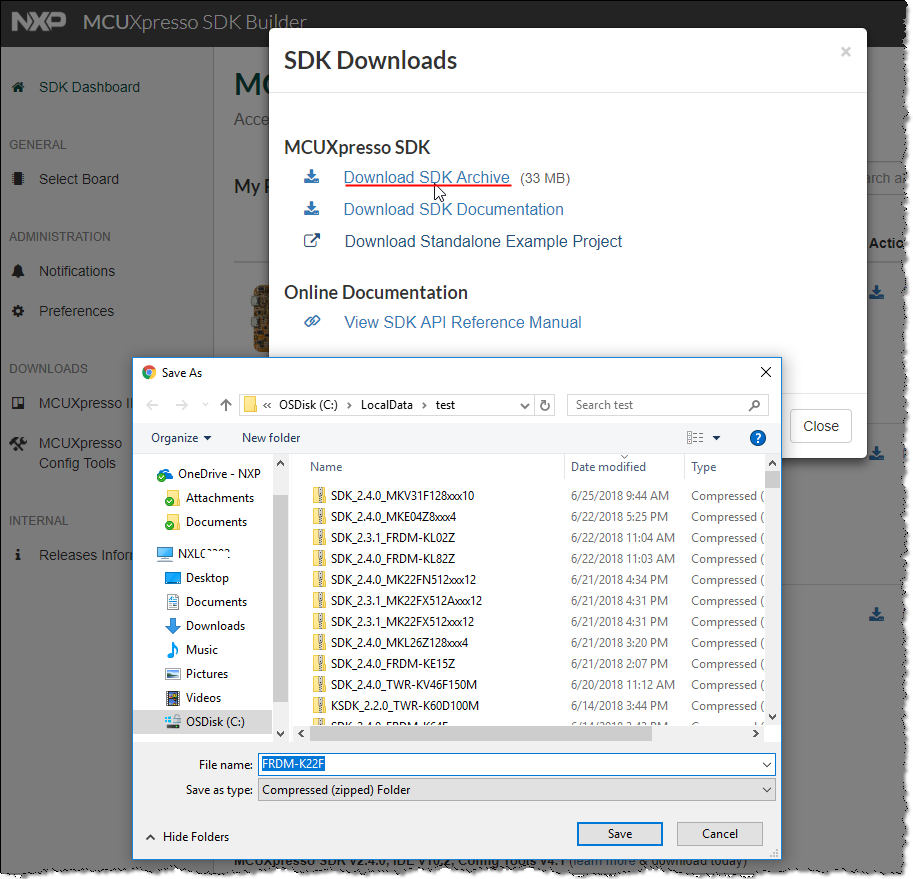

Please refer the images show below and download the latest MCUXpresso SDK.
1 Select and Build MCUXpresso SDK.png2 Download SDK.png3 Download SDK Archive.png
