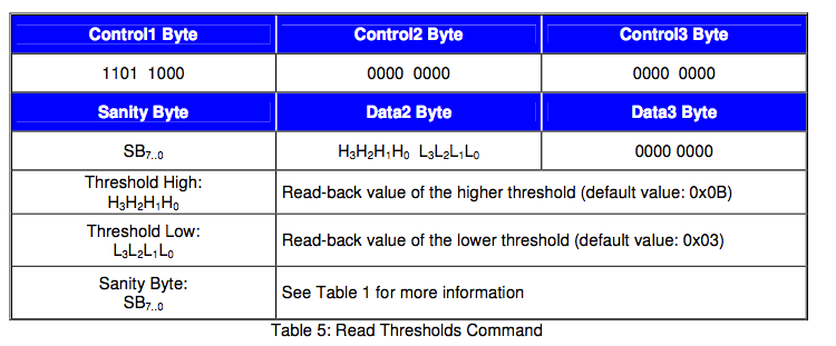

lucasmahieu
Hey Jeremy,
I am confused because I do't succeed to make my SPI connection working with DMA...
You gave me so many advice, but I steel have problems.
here my code :

extern uint8_t spi_rdata[3]={0xf};
#define RT 0b11000011
void test_RT(){
     volatile int i=0;
     uint8_t read[3]={RT,0x00,0x00};
     TERMINAL_PRINTF("TEST_RT - new_dma_data=%u\n\r",new_dma_data);
        SPI_write(read,3);
     for(i=0;i<1000000;i++);
     if(new_dma_data){
          TERMINAL_PRINTF("SB=%u\n\r",spi_rdata[0]);
          TERMINAL_PRINTF("Threshold=%u\n\r",spi_rdata[1]);
          TERMINAL_PRINTF("Zero=%u\n\r",spi_rdata[2]);
          TERMINAL_PRINTF("----------------\n\r");

8,374件の閲覧回数
jeremyzhou
Hi mahieu lucas,
I'm afraid that you can't receive 3 bytes correctly after 3 bytes had been transfered, as the SPI module doesn't have enough space or butter to storage the received bytes.
Hope it helps,
Ping
8,374件の閲覧回数
lucasmahieu
Rely thanks jeremy,
in fact the camera that I want to communicate with via SPI is sending 3 commande Bytes in the same time I send it 3 Bytes
but only the first commande byte is important (the 2nd and 3rd have to be 0000...0)
and only the (2nd and 3rd Bytes of the receive Bytes are used full).
