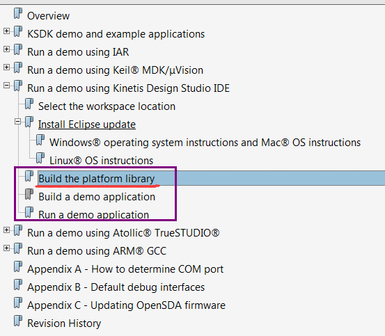

I'm new with this board platform (FRDM-KL27Z) and i was just follwing the tutorial, but when i was biulding appear those both errors and i tried to change the code, search other blink led, but nothing different happened, the same error is there yet.
Description Resource Path Location Type
make: *** No rule to make taerror.pngrget '../../../../../../lib/ksdk_platform_lib/kds/KL27Z644/release/libksdk_platform.a', needed by 'myProject_MKL27Z64VLH4.elf'. myProject_MKL27Z64VLH4 C/C++ Problem
make: Target 'all' not remade because of errors. myProject_MKL27Z64VLH4 C/C++ Problem

As I wrote, you probably need to first do the same thing with the library (the part that supplies the drivers and such for the KL27) before you can build the application. KSDK is old now and probably being phased out - it seems uses this technique as far as I remember - you may find it easier to use the newer builder technique (SDK 2.2), which doesn't need libraries.

I expect that you first need to import the platform library project into KDS and build it. Then the application will be able to find the library object that looks to be missing.

I tried this before like the tutorial video explain (File > Import > General > Existing Projects into Workspace > Browse > C:\Freescale\KSDK_1.3.0\examples\frdmkl27z\demo_apps\hello_world\kds > Finish. After this, I select the project and click on the "hammer" to biuld the project, but, unfortunately appear those erros that I wrote before. I unistall the software and change PC, but it's still happening.

Hi Tiago ,
- Please  refer to "Getting Started with Kinetis SDK (KSDK) v.1.3.pdf" (I attached it for you) to run KSDKv1.3 demo :
I think you missing the step of “Build the platform libray” .
- Now the latest version of KSDK is v2.2 , it is more simple to used,  I strongly recommend you use the latest versoin:
