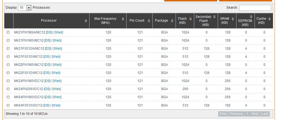

Dear Freescale Community,
in an application where physical board space is absolutely critical, I am looking for the smallest available 32-bit MCU that features CAN and DMA.
Can you give me a hint what MCU to take a look at?
So maybe MAPBGA81 (?).
Thank you a lot,
best regards,
Alex

You may find this post useful:
Is there a Kinetis Development board with a CAN Controller on it?

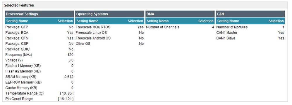

You can check the Freescale Product Selector selecting Kinetis ARM Cortex-M MCUs configuring the filter for CAN interface. You will see there several options for devices with CAN interface.
Also you can use the Product Selector Advisor. I used it configuring this options:
And this is what I received as options:
Hope this information can help you

alexanderbuerge
Hi Adrian,
thank you a lot for explaining how to find the best suited MCU. I chose MK10DX64VMC7. I think it just suits my needs.
Alex
