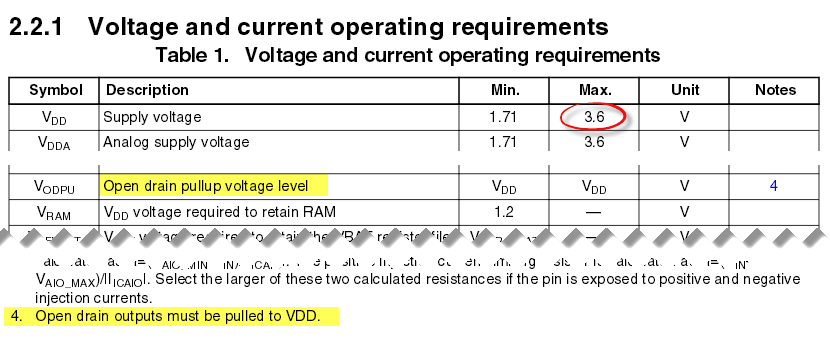

Hello, I need an output only level shifter from 3.3V to 5V (MCU -> IC). Is it possible to use only a pullup resistor or is an additional transistor required? I can't find any information about the protective circuit of the GPIO pins in the datasheets.

Hi Mike:
In that case you can only pull-up to VDD, which is maximum 3.6 V. Here is an extract from datasheet:

mike81
Hello Jorge Gonzalez,
the Kinetis part number is the MK64FN1M0Vxx12. Pins are PTE3 and from PTC4 to PTC12. If I understand this correctly it is not possible to configure the MCU pins as open drain output with external 5V pull-up?

Jorge_Gonzalez
Hi Mike:
