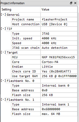

I'm attempting to program a K81 and QSPI (Micron MT25QL128 - 16MB, single die).  Segger J-Flash V7.54c shows error:
Timeout while preparing target, RAMCode did not respond in time. (PC = 0x00000000, CPSR = 0x00000000, LR = 0x61000000)!
Failed to prepare RAMCode using RAM
Error while determining flash info (Bank 1 @ 0x68000000)
Failed to auto program target
The J-Flash Project Info:
Has anyone encountered this, and can figure what's going on?

 J-Flash/J-Link V6.50a works perfectly. There's a bug in V7.45c, which I have reported to Segger.
Update Jan 20, 2022 from Segger:
Upcoming release of Segger J-Link/J-Flash will include fix for this issue.
The issue was due to a speed optimization that relied on the availability of an external reference clock, RTCK, which is not the case with many devices, including the NXP K8x.
Update Jan 25, 2022:
Segger J-Link/J-Flash V7.60f available for download.  Fix for K8x issue included in this release.

@nxf56274I'm not sure what you're saying. There is no external RAM, only the K81 with its onboard internal RAM.
As I understand the process, in order to write to the external QSPI flash, j-Flash/J-Link first downloads code to the MCU's internal RAM, sets the program counter and starts execution.  Thereafter, J-Link/J-Flash sends instructions and data to the RAM resident code, which relays it to the external QSPI flash.
