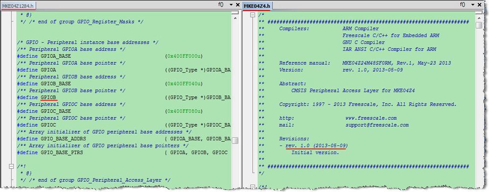

I am using MKE04Z128VLH4 micro-controller, and unfortunately I am not able to use GPIO's that are not GPIOB, I am getting compiler error.
I downloaded "FRDM-KEXX Driver Library Package" and used one of its project based on KE04 series on IAR.
Earlier I did the same thing for KE02 and it works properly.
The strange problem which I can understand is that the library doesn't support various things for this particular controller, I maybe wrong but please help me to understand this.
In file MKE04Z4.h, the following code is there.
/* GPIO - Peripheral instance base addresses */
/** Peripheral GPIOA base address */
#define GPIOA_BASE (0x400FF000u)
/** Peripheral GPIOA base pointer */
#define GPIOA ((GPIO_Type *)GPIOA_BASE)
/** Array initializer of GPIO peripheral base pointers */
#define GPIO_BASES { GPIOA }
which clearly tells me that there is no GPIOB, but in this micro-controller there is, so definitely I am doing something wrong.
One thing I noticed while posting this question is that the header file name is MKE04Z4.h, so it's Z4 and my micro-controller is KE04Z128, which I am using wrong library.
Although I am able to turn on the pins on GPIOB, by changing few things in library, but i can't these things for all drivers.
So is there any sample code or library available for MKE04Z128 micro-controller available, so that I can take reference from there and start building my project.

The MKE04Z4.h in "FRDM-KEXX Driver Library Package" is a old version 1.0 (2013-05-09).

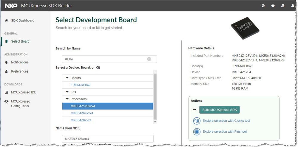

Please download the SDK_2.3.0_MKE04Z128xxx4. You will find the new headfile MKE04Z1284.h(2017-05-19).

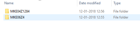

The micro-controller is KE04 series and why the libraries are aligned more with KE06.

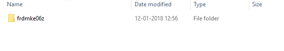

Actually I solved my problem with the old libraries, by just changing the macros in IAR Project Option from FRDM_KE04 to FRDM_KE06 and CPU_KE04 to CPU_KE06, and till now I haven't faced any problem.
Plus the SDK you shared, has something like this, I selected MKE04Z128 and even then SDK has some folders related to KE06 series.

I tried using KE06 Libraries for this KE04 micro-controller and they are working properly.
Why it is working like this??
