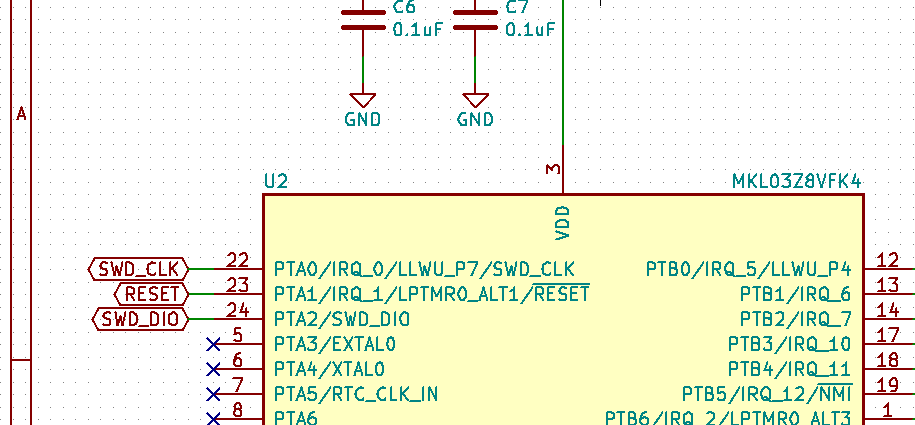

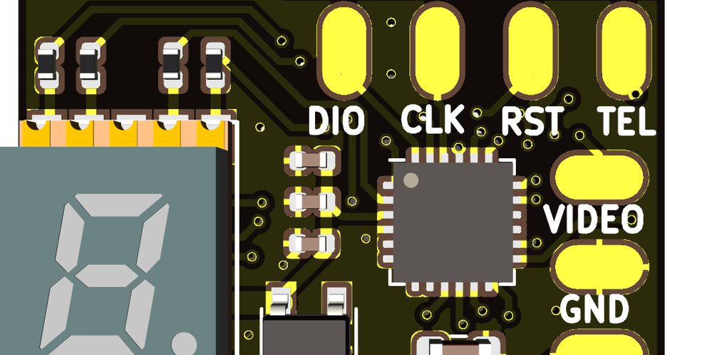

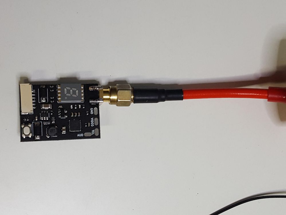

It's right this connection in order to program the KL03 32kb QFN-24 with the LPC_Link_v2 ?
With 3 wires, DIO, CLK and RESET because I can not put a SWD standard connector because I have not space.

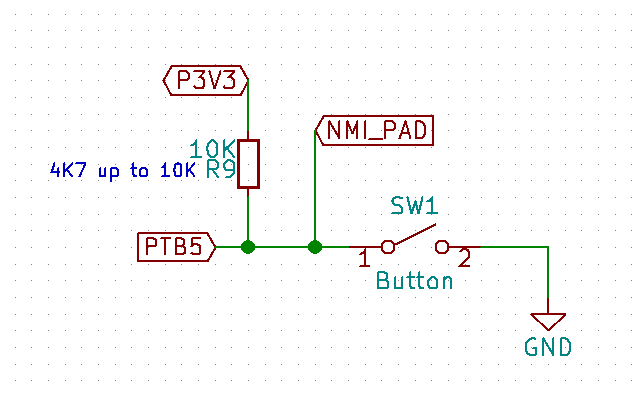

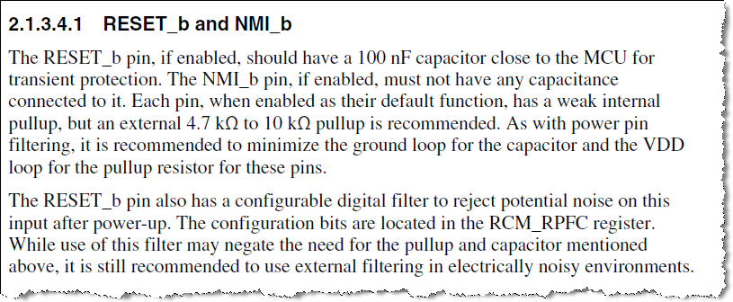

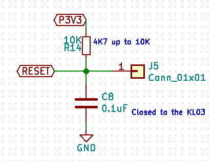

NMI_b(PTB5)     external pullup resistor
SWD_DIO(PTA2)    external pullup resistor
SWD_CLK(PTA0)
RESET_b(PTA1)    external pullup resistor / 100 nF capacitor
GND is needed when using LPC_Link_v2 connect to KL03.

SWD_DIO
RESET
Is the capacitor well connected? It's a 100nF 0402 ceramic capacitor.

I had already NMI pull-up 10K resistor and one button in order to enter in boot mode. It's necessary the NMI pad for use the LCP_Link2? It's enought with the button? I can remove it?
SW1 the only button I have on the pcb. I plan to use it to change channels/bands and to enter boot mode.
