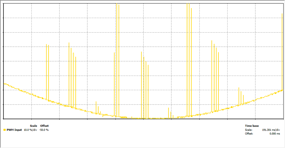

I have modified the TPM_PWM example to use freeRTOS and drive a motor.
The PWM signal was very noisy when I checked with an oscilloscope and also with a motor controller as shown below.
I changed the PWM frequency and for some reasons, it seemed to work better with higher frequency then stopped working after some value.
When I was checking with the oscilloscope, the measuring frequency was also changing. I assume there might be something wrong with the TPM source clock?
Here is the code I used and the TPM1_CH0 pin was used to send PWM out.
What the code does is, once the SW3 button is pressed and Motor_Switch is true, the sinusoidal duty cycle of PWM is sent out.

Hi Yaeyong,
If you want PWM change continuously, you can't call TPM_UpdateChnlEdgeLevelSelect() before and after TPM_UpdatePwmDutycycle().
If you call TPM_UpdateChnlEdgeLevelSelect() and then TPM_UpdatePwmDutycycle, register TPM.C0V will update immediately. Current PWM waveform will be incomplete.
 Another problem in your code is
        updatedDutycycle = (uint16_t) 450 + 350*sin(2*PI*Sin_time/1000-PI/2);
updatedDutycycle is a uint8_t type. But your expression show that updatedDutycycle's value is from 100~800.

Hello Jing,
Removing TPM_UpdateChnlEdgeLevelSelect() worked.
And I actually set updatedDutycycle to uint16_t before the attached code. Thanks for pointing it out though.
Thanks!.
