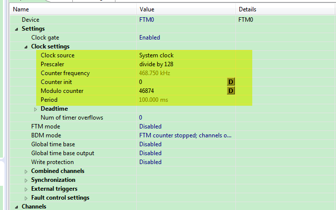

kerryzhou
Hi Brian Smith ,
  Please tell me the kinetis chip part number which you are using?
  Now, take the MK64 FTM as an example. K64 core clock is 120Mhz, the bus clock is 60Mhz.
  Then configure the FTM like this:
FTM clock source is sytem clock, it is 60Mhz.
Then prescaler is divide by 128, you will get the counter frequency as 468.75KHZ.
 Configure the modulo counter = 46874, you will the FTM period as 100ms, it is 100Khz.
 Now, you just need to configure the PWM duty and output is OK.
Wish it helps you!
Kerry

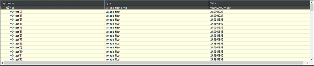

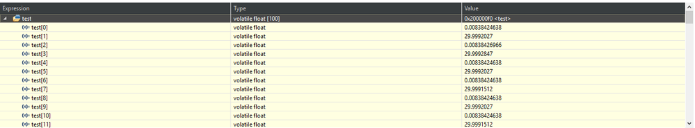

errorek123
So i did write a simple code to check if it works reliably and it does but only if i use abs when calculating difference othwise i got correct reading every 2 interrupts as attached on the picture below.

I checked some things and it seems like every second dma interrupt data is corrupted or somehow not in the correct order? Sometimes position 2 in my array is highter than position 0 which shouldn't be possible. I know there is one scenario i should take care of which is timer overflow  but it's not the problem here because it happens even before first timer overflow.
ABS function solves all the problems but how is it even possible? So it means that the data is just in the wrong order? Maybe i setup my dma wrong? I did setup my DMA for 4 transfers so the buffer always starts on the same edge.
With abs:
Without abs:
