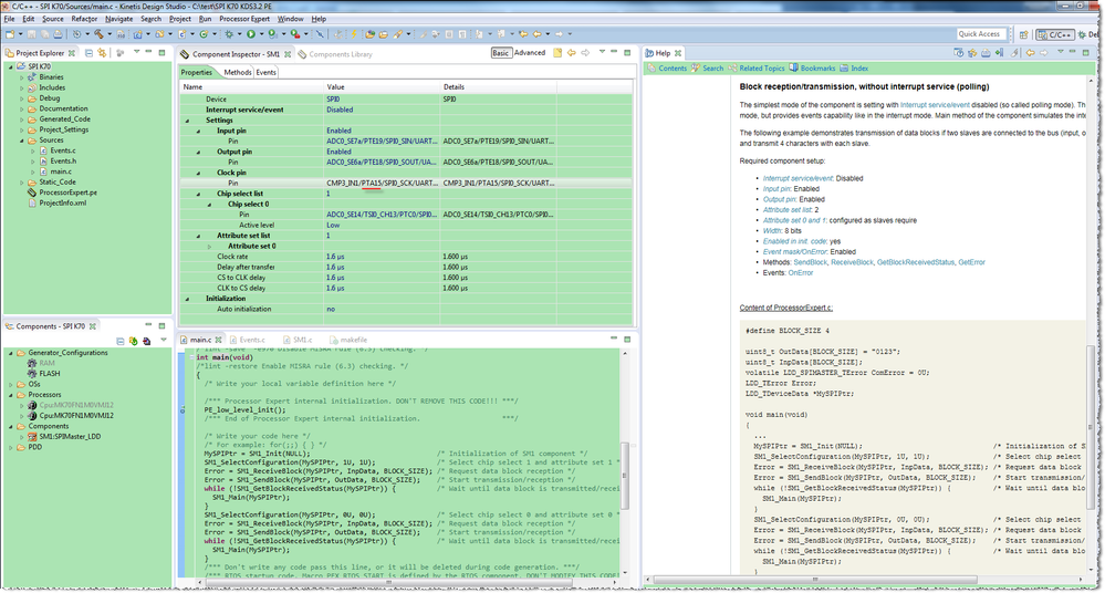

I am using kinetis design studio v3.2 and processor expert to write a code for spi on k70 chip (twr-k70f120m tower board) I have used the polling method example given by help component
but when i check there is no clock coming on spi:clk pin of the board
so to check whether program is running i also added a led blink code which blinks led every one second using timer interrupt,it is working but still no clock on spi:clk of the above board
What is missing in the code ?
I have used following component setup as per the example
Interrupt service/event: Disabled
Input pin: Enabled
Output pin: Enabled
Attribute set list: 2
Attribute set 0 and 1: configured as slaves require
Width: 8 bits
Enabled in init. code: yes
Event mask/OnError: Enabled
Methods: SendBlock, ReceiveBlock, GetBlockReceivedStatus, GetError
Events: OnError
following is main.c

Sorry for the late reply!
Would you please tell me which pin are you testing?
I test that SPIMaster_LDD polling example, there is clock coming on spi:clk pin(PTA15) of the board.
I have attach that project here, you can test it on your TWR-K70F120M board.
Robin
