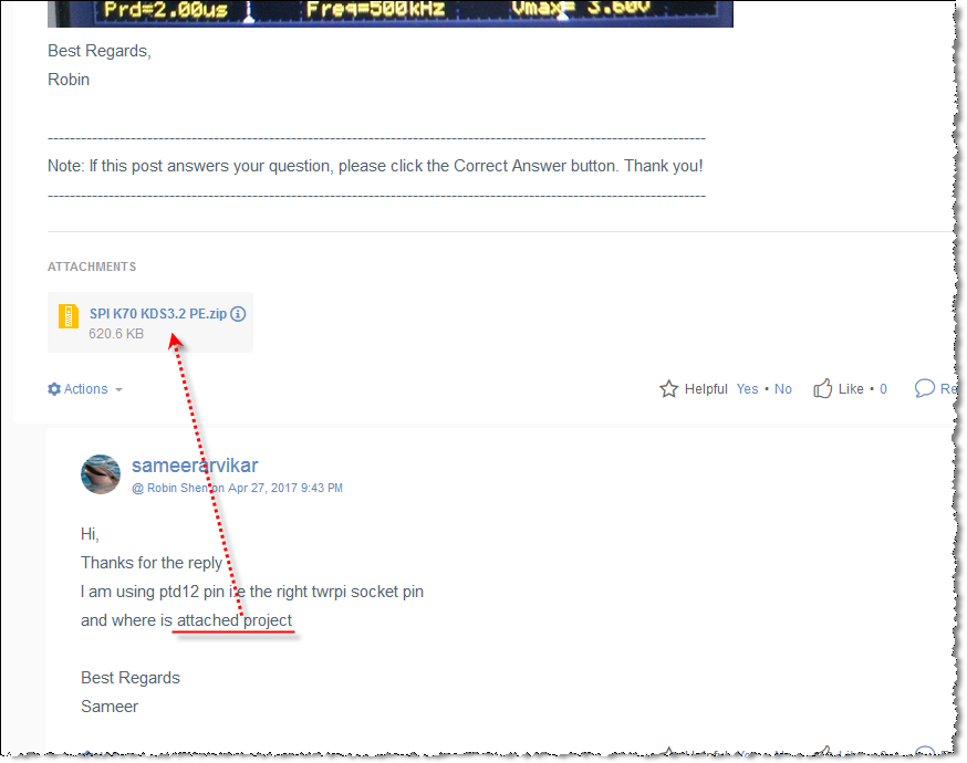

I am using ptd12 pin i.e the right twrpi socket pin
and where is attached project
Best Regards
Sameer
1,637 次查看
Robin_Shen
It was in my last reply.
