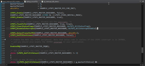

Habib_MS
Hello @jimmyli,
Could you run the master's code with the modification of setting this function to false? This change is intended to alter the behavior of the Chip Select:
Habib.

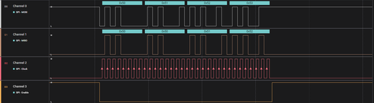

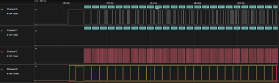

Habib_MS
Hello @jimmyli,
Due to not having the MCXC242, I tested your code on the MCXC444, but I was still able to replicate your issue:
Upon verifying the functionality of the example called "spi_interrupt_b2b_master", I observed the following:

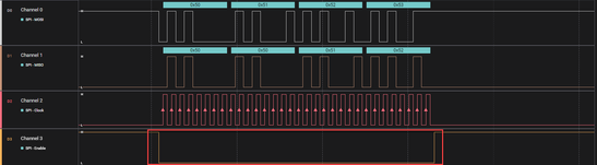

The Chip Select must be in IDLE during each data transfer. However, when checking the signals with your example, the Chip Select remains low, which causes the issue:
Therefore, by modifying your master's code as follows:
Both codes work correctly:
Could you verify that the Chip Select functions as expected, similar to the previous frame?

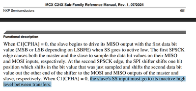

Hello @jimmyli,
In order to support you better, could you share the chip select functionality using an oscilloscope or logic analyzer when transmission occurs?
      3.1 why changing pcs mode from true to false affects master receiving the data ?
           3.2 the sequence of received datas from slave  is wrong, what's the reason ?
The issue could be related to the CPHA configuration. As mentioned in Chapter 35.5.7, "SPI Clock Formats," in the Reference Manual, when CPHA is configured to 0, the chip select must be idle between transfers.
For this reason, changing the chip select mode modifies the response of the MCXC142.
