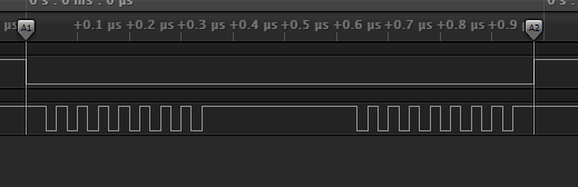

mjbcswitzerland
Specialist V
I have attached a binary that can be loaded to the TWR-K60D100M board that will try to find an SPI Flash device on the same pins as you use. After each reset there will be some activity where the CS line is controlled automatically.
Note that if the CS line is correctly configured it will be at '1' in the stable state (before doing anything in SPI2). If it isn't there is a bad configuration or the measuerment points are not good. The attached binary will enable ensuring that the measurement itself is not bad.
The code is as follows (as reference since it uses different methods to you which are however more fool-proof, yet should be just as easy to follow).
// Pin configuration
POWER_UP(3, SIM_SCGC3_SPI2);
_CONFIG_PERIPHERAL(D, 11, (PD_11_SPI2_PCS0 | PORT_SRE_FAST | PORT_DSE_HIGH));
_CONFIG_PERIPHERAL(D, 12, (PD_12_SPI2_SCK | PORT_SRE_FAST | PORT_DSE_HIGH));
_CONFIG_PERIPHERAL(D, 13, (PD_13_SPI2_SOUT | PORT_SRE_FAST | PORT_DSE_HIGH));
_CONFIG_PERIPHERAL(D, 14, PD_14_SPI2_SIN);
// SPI configuration
SPI2_MCR = (SPI_MCR_MSTR | SPI_MCR_DCONF_SPI | SPI_MCR_CLR_RXF | SPI_MCR_CLR_TXF | SPI_MCR_PCSIS_CS0 | SPI_MCR_PCSIS_CS1 | SPI_MCR_PCSIS_CS2 | SPI_MCR_PCSIS_CS3 | SPI_MCR_PCSIS_CS4 | SPI_MCR_PCSIS_CS5);
SPI2_CTAR0 = (SPI_CTAR_DBR | SPI_CTAR_FMSZ_8 | SPI_CTAR_PDT_7 | SPI_CTAR_BR_2 | SPI_CTAR_CPHA | SPI_CTAR_CPOL); // for 50MHz bus, 25MHz speed and 140ns min de-select time
// First byte transmission (byte is the value to send)
SPI2_MCR |= SPI_MCR_CLR_RXF; SPI2_SR = (SPI_SR_EOQF | SPI_SR_TFUF | SPI_SR_TFFF | SPI_SR_RFOF | SPI_SR_RFDF); // flush FIFO and reset flags
SPI2_PUSHR = (byte | SPI_PUSHR_CONT | SPI_PUSHR_PCS0 | SPI_PUSHR_CTAS_CTAR0);
// Final byte transmission (byte is the value to send) after which the CS will negate
SPI2_PUSHR = (byte | SPI_PUSHR_EOQ | SPI_PUSHR_PCS0 | SPI_PUSHR_CTAS_CTAR0);
This is the complete code to configure and send a couple of bytes.
The waveform is shown below.
Mark
Professional support for Kinetis: http://www.utasker.com/index.html
Remote desktop one-on-one coaching: http://www.utasker.com/services.html
Getting started to expert videos: https://www.youtube.com/results?search_query=utasker+shorts

mjbcswitzerland
Specialist V
Robert
I test the same binary on my TWR-K60D100M board in the tower with SER card and measure the waveforms as in the screen-shot after each reset.
It sounds as though you get the CS signal (asserts negative) which means that the CS line is essentially OK.
If you don't get the clock signal you must have a problem with the connection or the measurement.
Since the CS line does operate (the main topic) the HW is Ok with respect to this so you should be able to get your code to do the same.
Mark
