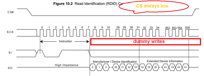

I am working with KL25Z controller.
I am using spansion SPI Flash S25FL128S
Can I directly use the low level driver to read particular register from DDR flash?
Or I have to do some initial setting?
I have directly read the RDID of flash by using SPI (Master) read.
RDID is unique IS of SPI Flash IC.
But i am getting 0x00 value in read buffer.

I was checking the Datasheet of the flash you are trying to interface and it looks it does not need any special configuration to read data. Like it mentions you just need to configure the SPI module in 2 of the tree different modes: mode0 or mode 3, check the section 4. Signal protocols in the document (http://www.spansion.com/Support/Datasheets/S25FL128S_256S_00.pdf)
The section 10.2.2 Read identification states that if you want to read the identification of the device you just need to write the command 9F, you need to have in mind that every time you want to read something from the device you write the command and after that you need to send dummy writes to the device in order to pop the data.
Try to check the signals in an oscilloscope and add the picture.

Hello  ,
Thanks for reply it was really helpful.
I have some doubt in it.
I am working with KL25Z128VLH4 controller using CW 10.3.
I have generated code for SPI0 (mode 0) using PE in CW 10.3.
As I said I was not able to read the ID from Spansion memory IC.
My code was not working.
But refereed  from the "READ_ID Command Sequence" .
I disable the CS pin from SPI setting (All other parameters are same) and make CS pin as "BitIO_LDD"
And I Clear the bit before reading ID and again set it.
Now its working.I can read RDID of memory IC.

This is not exclusive for the Flash memories, it is a very recurrent practice when you are using SPI communication and you want to control and ensure when the CS signal is going low or high. It is used for the SPI protocol itself, this is because is the CS signal is the one that indicates the start and the end of the frame.
As in the datasheet of the flash says the DDR option is also supported, in the section 4.1.2 Double Data Rate (DDR) mentions: “Mode 0 and Mode 3 are also supported for DDR commands. In DDR commands, the instruction bits are always latched on the rising edge of clock, the same as in SDR commands. However, the address and input data that follow the instruction are latched on both the rising and falling edges of SCK.” The problem here is that the SPI module in the Kinetis KL (nor Kinetis K) devices is a simple SPI module and it does not support this type of frame where the data is latched on the rising and falling edges, it only supports one edge for the data.

I know that CS should go low while transmission of data and again high after data transmission.
When I used PE generated code my CS bit is going low for every byte and again high after byte transfer.
But from memory IC datasheet the CS should be Low for whole data transfer. So I made it as BitIO_LDD and clear and set pin before and after data send. With this my code is working.
I am cleared about the DDR concept.
