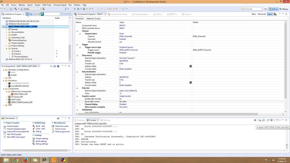

Using the below PE settings I am able to transfer 8 bytes of data but my buffer contains 15 bytes of data. So whats the process of transferring all the data present in the buffer? I have used DMAT_Ldd component from PE. I am using FRDM-K20D50M board with codewarrior 10.5.

Hi Amit,
I didn't figure out the problem after I had a brief look through the screenshot you provided,
So I'm wondering if you could upload your project to the community.

I think I've found the reason of why only 8 bytes have been transfered.
From your project, you set the [Transfer control]: Single transfer, when triger source:UART transmit exist, then DMA will transfer all 16 bytes to UART data register immediately.
However the UART0 have only 8-entry transmint FIFO which mean it can store 8 bytes and the FIFO will bypass other bytes.
Final, we've just received 8 byte from UART0.
