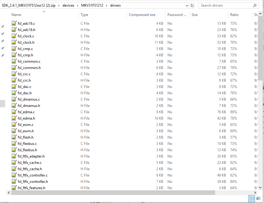

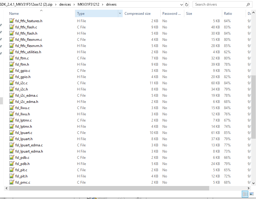

Is there an SPI driver available for the the KV31F series parts?  I just downloaded the latest version (2.4.1) for the MKV31F512xxx12 series parts, and there is no SPI driver under the driver folder.  Where can I get the SPI driver for the KV31F512?
EDIT: This appears to be an issue with just the MKV31F512 SDK.  I downloaded the SDK for the MKV31F256 and the SPI drivers are included.
2,031 Views
jorge_a_vazquez
I can confirm that there is a problem with the SDK package of the KV31F512, it doesn't include the driver for the SPI. I will report this internally, thanks for pointing out this issue.
