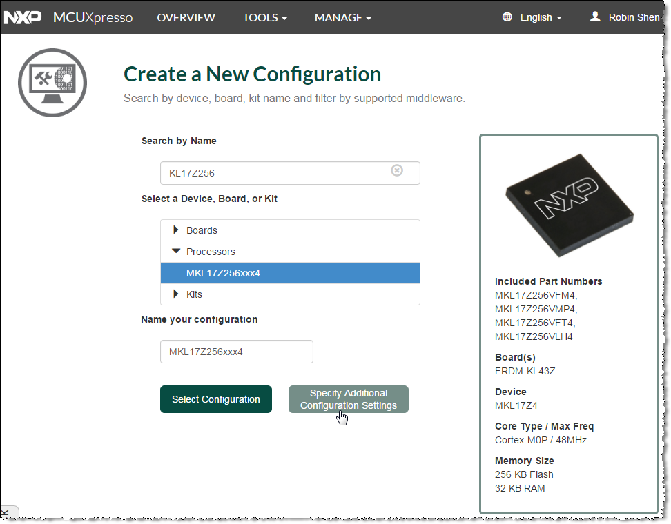

I recommand you using Kinetis SDK v2. You can download SDK_2.1_MKL17Z256xxx4 from here.

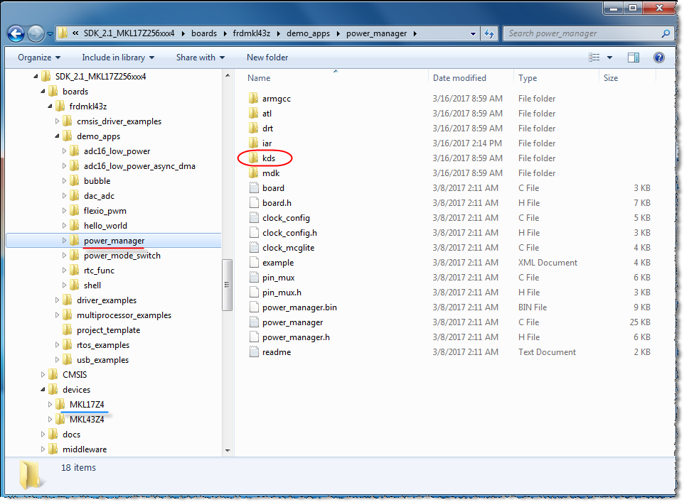

The power_manager project with Kinetis Design Studio can be found in below folder:
