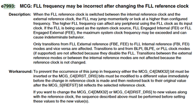

Hi, I found a comment in the SDK which says there was a errata007993.I want to know what it is and the impactrt on the Mk60FN or Mk60DN.Thanks.

Hi YuZH,
As Erich said, you can use Google to search. Or you can search on the NXP official website:

Google (usually) is your friend, for example in
https://www.nxp.com/docs/en/errata/KINETIS_K_5N96B.pdf
search for 7993.
