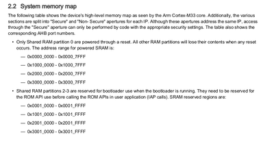

First, find in your reference manual a region of SRAM that remains power through a reset. In my case (mx rt 595), thats SRAM partition 0.
It's address range is:

1. Add a memory region. In our case, m_persistent. I placed it at the beginning of the above-mentioned partition.
