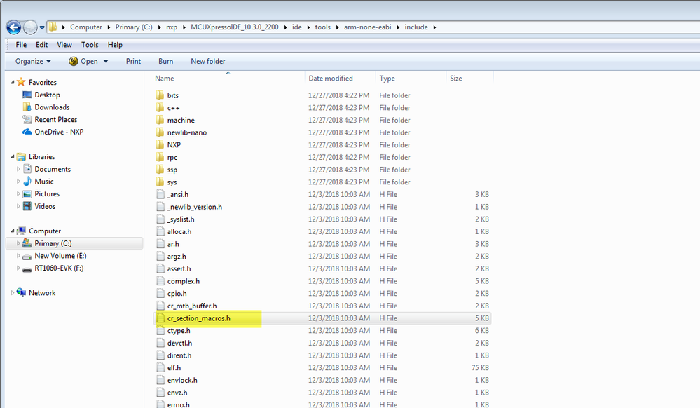

I want to placing specific functions into RAM blocks, so I use the the macro __RAMFUNC and add the  #include <cr_section_macros.h>  to my header file, but the MCUXpresso IDE tell me “Could not find include file "cr_section_macros.h" on include paths”, and the function is still in the .text section. How can I solve this problem?
By the way, I‘m using KL17Z128VFM4 MCU and my MCUXpresso IDE version is 10.3.1.

kerryzhou
Hi James Xie,
   If you just lack "cr_section_macros.h", you can add that file path, the path is:
C:\nxp\MCUXpressoIDE_10.3.0_2200\ide\tools\arm-none-eabi\include
But, please check your IDE path, you need to add the path in your project, then you will have this file.
Wish it helps you!
