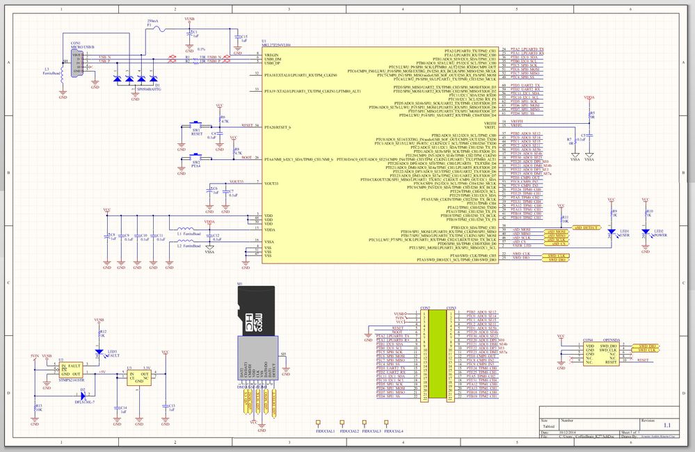

In the circuit, I have a button on the PTA4/NMI_b pin.

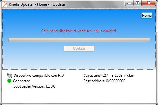

ernestoandresri
Yong Li,
Thank you very much. With your instructions, able to successfully configure the bootloader option. I programmed the microcontroller and everything happens as expected. Reenters Bootloader but now I have another problem.
The settings in the memory locations are:
  • The values were verified in the generated .bin and were as expected.
  • I programmed the microcontroller using KinetisUpdater.exe... programming ended without any problems.
  • Try entering again into Bootloader mode and I could do it without any problems

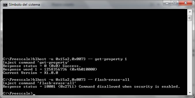

  • Now I always get an error when trying to program a microcontroller again. Now I always get an error in KinetisUpdater.exe.
from blhost, you can see that answering the bootloader, but leaves no programming or erasing the flash
Apparently it is the memory register "Flash Security Register (FTFA_FSEC)" ... I had reviewed this register to set up the right way and I think I gave the correct values.
I gave the = 0xFE values corresponding to:
  • KEYEN = 11 Backdoor key disabled access
  • MEEN = 11 Mass erase is enabled
  • FSLACC = 11 Freescale factory Access Granted
  • SEC = 10 MCU security status is unsecure. (The standard shipping condition of the flash memory module is unsecure.)
something is wrong with what I'm understanding?

  If you verified that FTFA_FSEC(offset 0x40c) was 0xfe in the generated .bin, Chip should be unsecure after programming, but from the error info of blhost and KinetisUpdater, seems chip was still secure(you can use 'get-property 17' to get current flash security state (should be SECURE)), When chip is secure, the flash related commands(write/read/erase-all) in ROM are disallowed, So you can't program the chip again by KinetisUpdater.
  Can you help try below steps by blhost?
   Step1: blhost -u -- flash-erase-all-unsecure
   Step2: blhost -u -- get-property 17
       Returned info should be "Flash Security State = UNSECURE"
   Step3: blhost -u -- write-memory 0x0 generated .bin
   Step4: blhost -u -- read-memory 0x40c 1
       Returned value should be "fe"
   Step5: blhost -u -- reset
   Step6: blhost -u -- get-property 17
   Step7: Press the reset button and wait 5s, you should see your app working.
If above steps work on your side, that means updating app by blhost is properly.
  Contine to try below steps:
   Step8: Press the reset button and run blhost -u -- get-property 17
   Step9: Update the app by KinetisUpdater
   Step10: Press the reset button and run blhost -u -- get-property 17
       Returned info should be "Flash Security State = UNSECURE", if not, this security issue should be caused by KinetisUpdater.
11,473 Views

Now I have a new detail. I'm using the USB Bootloader for KL27 ... after all, it works great.
The problem comes when entering Bootloader, the PC recognizes the USB-HID device, but sometimes enters bootloader mode but UART port . That ends BOOT USB and requires a RESET to reenter by USB-HID.
The hardware solution is to place PULL-UP resistors in PTA1 and PTA2 pins, especially in PTA1. But already made the PCB and can not take that option.

I also designed a custom PCB with KL27. I was hoping to use the USB ROM Bootloader but it does not seem to be detected by the PC.
Luckily, I call fallback on the UART Boot ROM.
In your comment you said "The hardware solution is to place PULL-UP resistors in PTA1 and PTA2 pins, especially in PTA1" to make the USB-HID ROM Bootloader more reliable. But I cannot find any other information in the documentation about this fact.
Have you got any explanation for these PULL-UP resistors?
