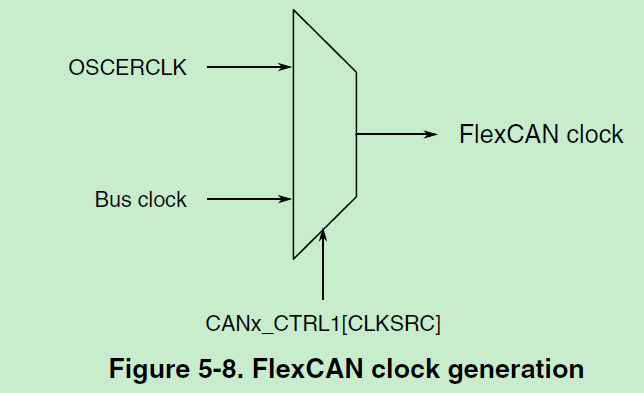

Hui_Ma
The FlexCAN module clock source could from Bus clock or from OSCERCLK.
From your description, the MCG works in FBE mode with external 32KHz crystal clock.
So, I think the FlexCAN module clock is 32KHz clock, right?
And the core and bus clock is also 32KHz, right?

norton256
That is correct that the whole system is running off of the 32KHz clock, with the CAN module set to use the bus clock.

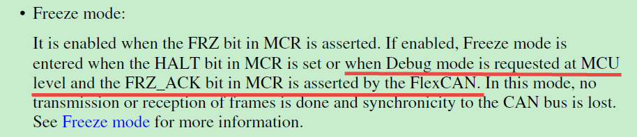

When a K60 is halted from the debugger, does the CAN peripheral essentially go into freeze mode? Other peripherals explain how they react when the debugger takes control, but the CAN module does not.
9,772 Views
Hui_Ma
The FlexCAN module has below description about MCR[FRZ_ACK] bit. When debugger halt the MCU, this bit will be set. So, your previous observed this bit is set during debug is normal.
Wish it helps.
Ma Hui

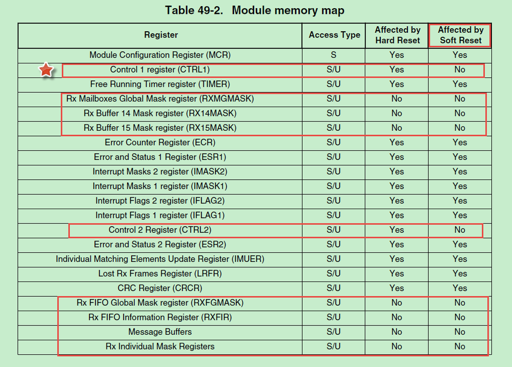

After each clock switch I reprogram the required baud and timing registers only. But I do not halt (enter freeze) the peripheral before I switch the clocks.
Are you suggesting that I perform a soft reset on the CAN peripheral and then perform a full re-initialization?
9,772 Views
Hui_Ma
After the clock switch, I recommend do a FlexCAN module software reset and then with a full re-initialization.
For the FlexCAN software reset doesn't affect CTRL1, CTRL2, RXIMR0–RXIMR63, RXMGMASK, RX14MASK, RX15MASK, RXFGMASK, RXFIR, all Message Buffers. Customer need to make sure previous setting value in those registers be cleared before set a new value.
Wish it helps.
