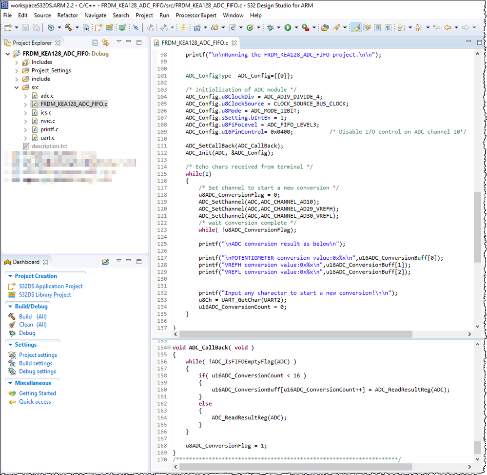

Hi laonia,
Seems that you are using KEA MCU. Please refer the example FRDM_KEA128_ADC_FIFO of FRDM-KEAZ Freedom Evaluation Board – QSP.
Robin
