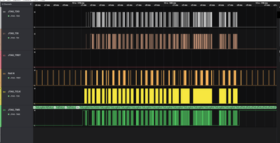

Hello
I'm working witch two MK60DN256VMD10.
As a debugger I use PE micro multilink (j-tag won't work at all, there was problem witch reset).
Unfortunately, it seems I somehow brick botch of my processors.
I tried to use method described in:https://mcuoneclipse.com/2013/06/16/bricking-and-recovering-frdm-kl25z-boards-reset-swd-clock-and-lo... but not help.
Below Jtag capture, it seems that CPU respond something.
Did you know some other methods, and maybe know what may happen?
 Many thanks for help

gronoarona
Thanks for fast answer.
I solved the problem, it turns out the problem was capacitor on nReset signal.
But as always, it takes time to find a problem.
