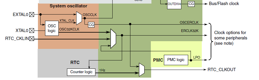

Hi everyone,
I am developing a battery backed-up application with MKL36Z256VLL4 where the device enters VLLS1 when mains power is not available and wakes up as soon as mains power is available again. Power to MCU is supplied from the battery when there is no mains.
A 32-kHz crystal is connected to oscillator pins and the MCU runs at ~48 MHz during normal RUN mode. I am using FEE mode for MCG configuration. RTC clock source is selected as OSC32KCLK in SIM_SOPT1 register and works fine during RUN mode.
The device must keep date and time during RUN mode and VLLS1 mode. I am able make MCU to enter and exit VLLS1 successfully. Since it is a battery powered application I want to reduce sleep current as much as possible. To do this I want to turn off OSCERCLK before entering VLLS1. According to reference manual this should not harm RTC operation since RTC clock source is selected as OSC32KCLK in SIM_SOPT1 register and this clock source is not derived from OSCERCLK.
In order to keep RTC running during VLLS1, oscillator is kept ON (ERCLKEN = 1) always. However when EREFSTEN bit in OSCx_CR register is cleared before entering VLLS1, RTC stops working (time does not increment) until the MCU wakes up and reconfigures the oscillator with EREFSTEN = 1. If I do not clear EREFSTEN  before entering VLLS1, RTC keeps track of time well during VLLS1 but this results in an increased sleep current.
What am I missing? How can I turn off OSCERCLK in VLLS1 mode while keeping the RTC run?

Dear Mark,
Using LPO is not an option due our accuracy constraints. So I have to use OSC32KCLK in all modes.
The problem is with the EREFSTEN bit not with ERCLKEN. During VLLS1 I want to get rid of OSCERCLK not ERCLK32K. Since ERCLK32K is not derived from OSCERCLK, turning off OSCERCLK should be ok and RTC should be working fine in VLLS1. However that's not the case.

I agree with you that the report is not correct in this case since the RTC is usable in VLLS1 when a 32kHz crystal is available. [The report concentrates on Freedom boards with LCD and high frequency crystal and needs to be extended].
From the block diagrams given in the user's manual it does look like it should be possible to disable OSCERCLK without disturbing the RTC but if practical tests show otherwise it may be that the diagrams are not fully accurate or it may be that there is a chip errata (check the errata to your chip to be sure).

My FRDM-KL46Z board (super-set of, and compatible with KL36) has a 16MHz oscillator so I couldn't test the case on this but instead I tested on the FRDM-KL43Z. This doesn't have the same clock module but the board has a 32kHz crystal and the oscillator/RTC part is the same:
I run the CPU from the IRC48M and use the system oscillator as 32kHz exclusively for the RTC.
My results are the same as yours.
As long as OSC_CR is set to 0xa0 (oscillator enabled and OSCERCLK runs in stop mode) the RTC will continue counting in low power modes (VLLS1 for example). As soon as OSC_CR is changed to 0x80 (enabled but OSCERCLK stops in low power modes) the RTC freezes when in the low power state.
The exception is VLLS0, where the RTC always freezes, irrespective of the OSC_CR value: this is expected since it is stated so in the user's manual.
Therefore my conclusion is, based on your reports with the KL36 and my tests with the KL43, is that the RTC freezes when OSCERCLK is stopped in STOP modes (including VLLS1) which is not expected according to the block diagram. The block diagram suggests that the RTC can continue to run from OSC32KCLK when OSCERCLK is stopped but this seems not to be the case when controlled by the OSC directly.
HOWEVER if the RTC_CR is configured to control the OSC via its OSCE bit (CLKO can also be set to 1 so that it doesn't supply the clock to other peripherals) OSC_CR can be left at 0.
Now the RTC continues counting in VLLS1.
I don't have a multi-meter with me at the moment (being on holiday with just a few basic boards to work with) so I can't confirm that the current is lower like this than the OSC_CR = 0xa0 setup. But you can try the same with your KL36 board (it has the same RTC registers) so see whether it does represent a way to stop the maximum internal peripheral clocks while allowing RTC operation in VLLS1 (and various other low power modes).
That is, try OSC_CR = 0; and RTC_CR = 0x300; instead of OSC_CR = 0xa0; and see whether it gives you better low current performance or not!

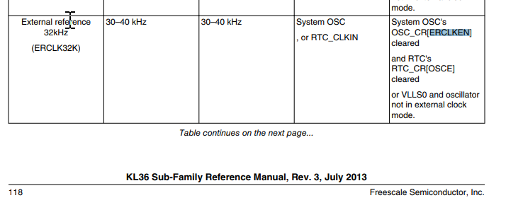

Dear Orhan,
If you check in the next section of the reference manual, you will see that the RTC needs a clock source to operate:
I think you're using the OSC32KCLK and as the page 118 says, the external clock will be disabled:
I think if you change the source of the RTC and enable the LPO before enter VLLS1, the RTC will continue operating.

Dear Alexis,
As you mentioned I use OSC32KCLK as RTC clock source and keep ERCLKEN always set in order to guarantee proper RTC operation in all modes.
