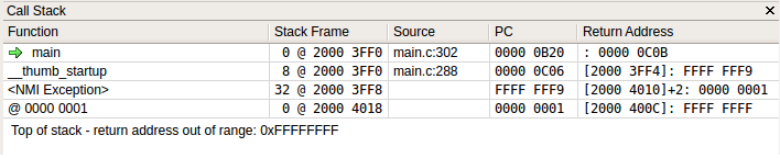

For one of the projects, we are using MKW36 chip, In which NMI pin used as wakeup source, so in FOPT we enabled NMI.
On reset, while booting, NMI is triggered and always enters into NMI handler. When looked into call stack it is observed that there is an NMI exception from where NMI handler is invoked.
In this scenario, the reset handler (_thumb_startup) is invoked two times. How to handle this situation? Can you please help us in understanding the code execution flow in this scenario.
As per the Reference manual, when NMI is active low processor executes an Exception entry and reads address of NMI handler from Vector table offset 8, and begins execution at NMI interrupt handler. But the call stack given below looks different and the PC value for NMI Exception shows 0xFFFFFFF9, this call stack is captured from J-Link debugger.

NMI handler is already defined and is invoked on bootup, in handler the NMI pin is configured to other alternate function, there are no repeated NMI interrupts observed.
There is an observation, the reset handler (_thumb_start) is invoked twice. As per my understanding reset handler should be called only once.

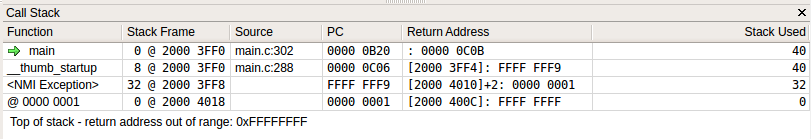

During debugging I added a breakpoint in main function which is invoked from reset handler, here is the call stack once after entry into reset handler

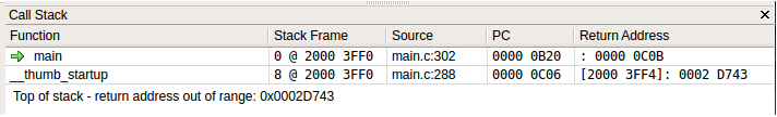

When I give run, the next call stack shows as given below, the control returned back to main again.
In first call stack frame, the 'NMI Exception' PC address shows as 0xFFFFFFF9, Is it valid address? As per my understanding, the PC address in call stack for this should show the NMI handler address (vector table offset 8). Is it because handler invoked before initialization complete?

Since the NMI interrupt will be taken immediately out of reset it may not be that easy to clearly see what happens with the debugger. Basically it sounds as though it is working as it should.
The 0xfffffff9 is the EXC_RETURN value - see Cortex Interrupt documentation for details - and this post: https://community.arm.com/developer/ip-products/processors/f/cortex-m-forum/4557/cortex-m4-exception...
