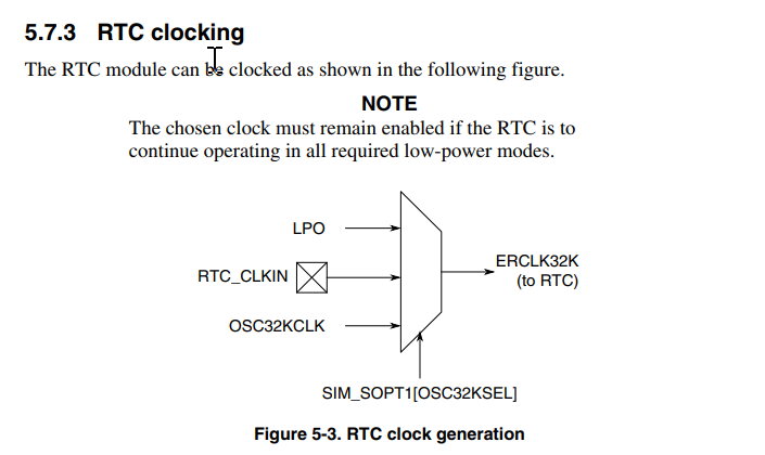

Dear Orhan,
If you check in the next section of the reference manual, you will see that the RTC needs a clock source to operate:
I think you're using the OSC32KCLK and as the page 118 says, the external clock will be disabled:
I think if you change the source of the RTC and enable the LPO before enter VLLS1, the RTC will continue operating.
I hope this helps you.

Dear Alexis,
As you mentioned I use OSC32KCLK as RTC clock source and keep ERCLKEN always set in order to guarantee proper RTC operation in all modes.
The problem is with the EREFSTEN bit not with ERCLKEN. During VLLS1 I want to get rid of OSCERCLK not ERCLK32K. Since ERCLK32K is not derived from OSCERCLK, turning off OSCERCLK should be ok and RTC should be working fine in VLLS1. However that's not the case.
How can I turn off OSCERCLK in VLLS1 mode while keeping the RTC run?
