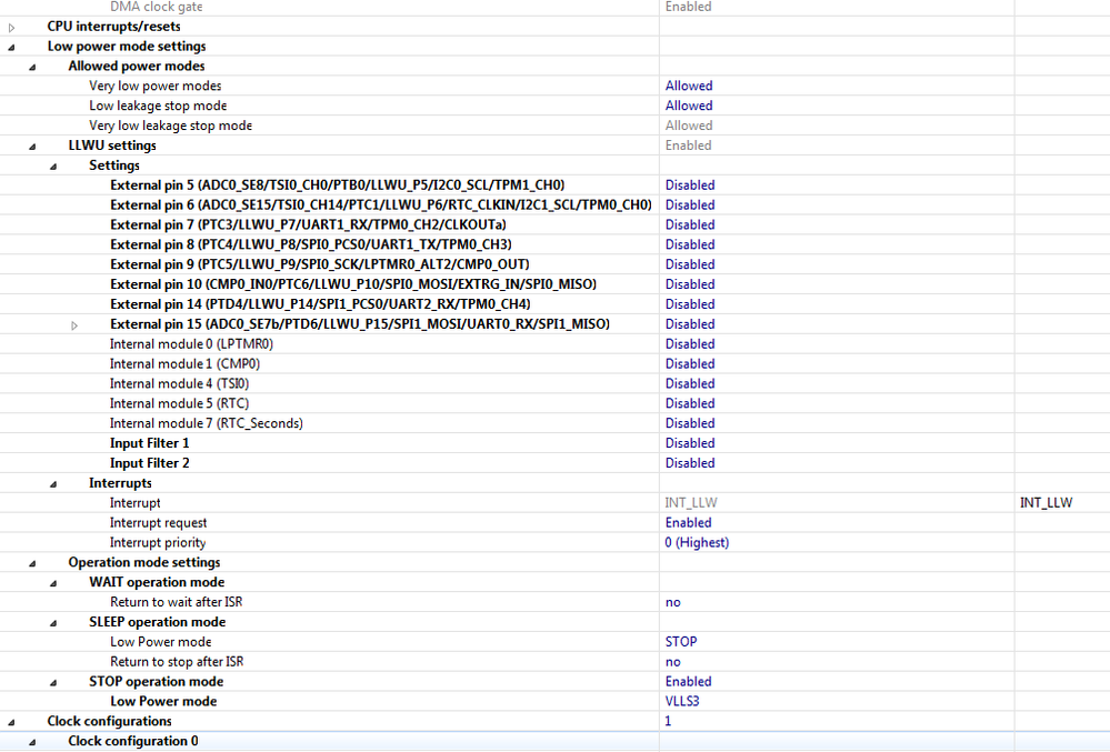

I just started useing Kinetis L25 Controller with ProcessorExport. Now I face a Problem when I try to use the Sleep-Mode with a running RTC.
I have an auto-initializing RTC-Component which is running well.
I have "Very low power modes" and "Low leakage stop mode" allowed in "Cpu/Low power mode Settings/Allowed power modes".
I have all Settings disabled in "Cpu/Low power mode Settings/LLWU Settings/Settings" even "RTC" and "RTC_Seconds"
(See image below)
I Switch to the sleep-mode with the following command:
Cpu_SetOperationMode(DOM_SLEEP, NULL, NULL);
Without RTC I remain in sleep-mode forever. With the RTC enabled I just wake up again with ERR_OK as return code. I do not really understand this behaviour because RTC and RTC_Seconds are disabled in the LLWU settings. Can anyone give me a hint what is happening here?
Thank you for any help .. Dominic

astdom01
Hm, I think I found my mistake partly.. when I use DOM_SLEEP I use VLPS mode and not LLS mode as I expected. In VLPS mode LLWU is not used and therefore LLWU configuration has no effect (as I understand). Instead AWIC is used and that explaines why the controller wakes up on RTC interrupt.
In this sense my program behaves as expected now - as long as I use the debugger to run it. When I flash the programm and power the device without debugger attached it remains in sleep mode and does not wake up. That's very strange! I hope to find this problem too.
Thank you for any hint. Best regards, Dominic

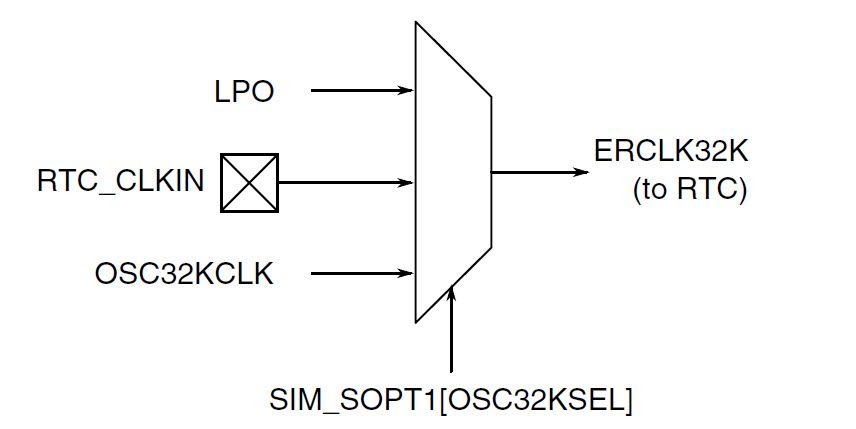

astdom01
Thank you for your reply .. I think I am on the trace! I use the hack where the 32 khz is looped back from PTC3 to PTC1 as described here:
https://community.freescale.com/docs/DOC-94734
And I use LLS mode (DOM_STOP and Low power mode settings/Operation mode settings/Stop operation mode = LLS ) but the RTC clock generation does not work when the controller is sleeping. I think this does not work in LLS mode because the output pins are latched.
Is it true that I need to use an external 32 khz clock generator for the RTC if I want to use it in LLS mode?
Thx, Dominic
3,719 Views
adriancano
I hadn't done it but regarding the Reference manual also the LPO can be selected as the ERCLK32K clock source, check the comments on the https://community.freescale.com/docs/DOC-94734 document. Some members present a different way to use the RTC.
The LPO clock remains on VLLS3 mode.
