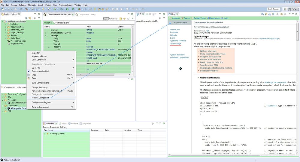

I want to establish a serial communication between TWR SER with an external device(BK Precision's Programmable DC Electronic Load). I plan on using the AsynchroSerial feature on processor expert. I want to know if this approach is correct and I'm open to suggestions. Also, if there are example projects on this feature in KDS or CodeWarrior?
3,682 Views
Robin_Shen
Hi Kiran,
Please refer the Typical Usage of Component AsynchroSerial.
Robin

Robin_Shen
Hi Kiran,
Robin

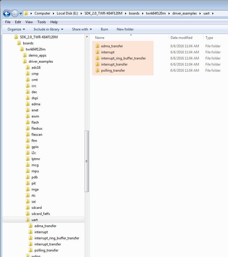

Are there any examples in KSDK for AsynchroSerial?
3,682 Views

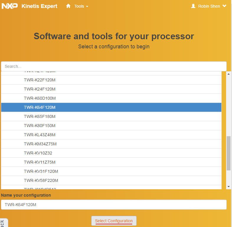

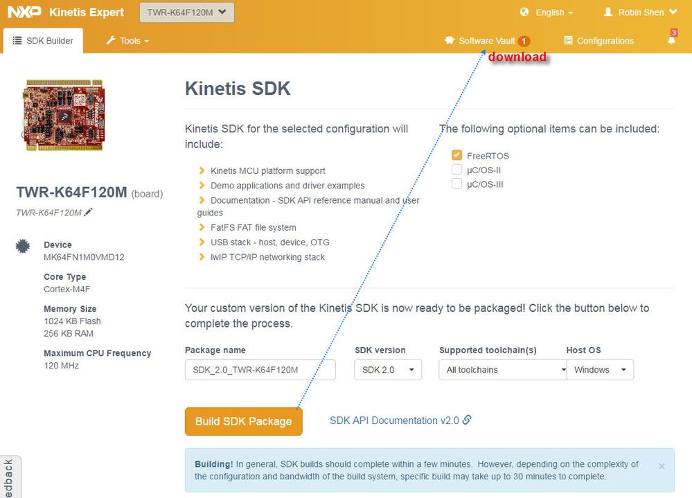

Robin_Shen
Hi  kirantujare,
There are many examples in KSDK2.0 for asynchronous serial communication(UART). These examples are not based on Processor Expert.
You can download it from Kinetis SDK Builder (REV 2 & 1.3).
Robin
