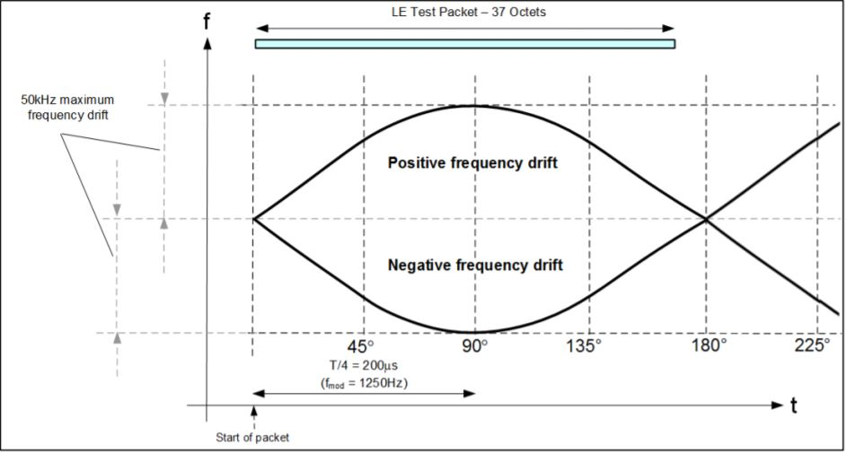

In addition to fixed frequency offset, frequency drift over time is added to the signal characteristics. This is implemented by adding a low frequency modulation to the signal. The modulating signal shall be sinusoidal with deviation of 50 kHz and a modulation frequency of 1250 Hz. The modulating signal shall be synchronized with the packets so that packets start alternately at 0° and 180° of the modulating signal.
