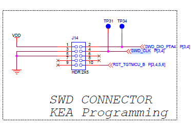

I'm using the FRDM board. What I would like to do is use the development board to program an S9KEAZN32AMLC MCU which is already soldered on a custom PCB. I do not own any sort of programmer. I would also avoid making any modifications to the development board. Can't I simply somehow use the development board pins to program the external MCU with the S32 IDE?

2. Remove your FRDM-KEA128 on board R101:
3. connect your FRDM board J14 to your own board swd interface:
Now, you can use the JLINK commander to check your external board, whether it can find the ARM core, if yes, then you can debug the external MCU.

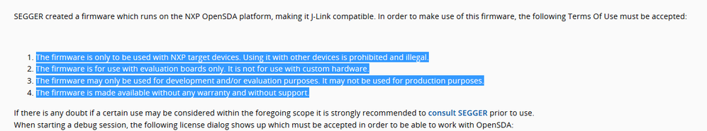

   But please note the comment from segger side:
https://www.segger.com/products/debug-probes/j-link/models/other-j-links/opensda-sda-v2/
If you want to debugger the external board in the development phase, you need to disconnect the on board SWD_CLK pin connect to the on board MCU chip. Take TRK-KEA128 as an example, you need to remove R4, but if you just replace the NXP on board chip, you don't need to modify the board.
