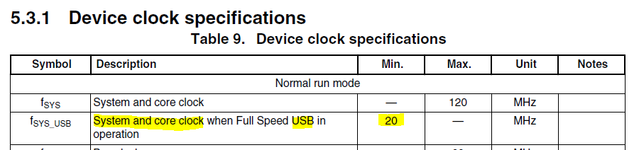

For FS USB operation on the K22 the system and core clock must be >= 20MHz.
Does this explain the problem?

If core clock have to be 20Mhz or more it sure does, as I do not change the clock when transitioning from VLPR to RUN, so running at 4MHz core clock.
When I think about it it sounds logical, that that big a freq-difference could cause problems, been assuming that the clock have been the issue, but not that it was to slow :smileyhappy:
Where did you get this information ? Can't remeber having seen this in the datasheet ?

This is a standard requiremenet for all USB devices (not just the K22).
Unfortunately the USb stack 4.1.1 doesn't do any clock checking, whereas it is best if the compiler already warns you that something could be wrong.

Haven't looked at that table before, but it sure explains what you are saying.

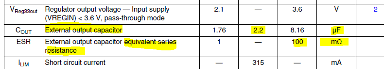

Right now the voltage regulator in/output is not tied to anything, I can see from the schematics on the freedomboard that there is a 0.1uF capacitor tied to it.
From the datasheet I see that the recommendation is to tie VREGIN together with VREGOUT through a 10k resistor to ground.
Could this really be the reason for this not working ? It can't be that simple :smileyhappy:

For PLL you "need" to use an external crystal (eg. 2MHz..16MHz) - for USB device only IRC48M is usually best.
There are various recommended circuits for the regulator, depending on where the power is supplied from and the voltage used.
However the external output capacitor is specified and without it it "will not" work correctly
As I noted before, this is where many new designs have an initial error.
Mark

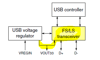

The VOUT33 is used to power the USB transceiver.
If you ground it your USB won't be able to work.

Ahh.. Just found this picture in the reference manual right now, and feeling kinda stupid :smileyhappy:
Thanks for not RTFM'ing me sooner :smileyhappy: this totally explains my problems. The freedom board do have VBUS connected to the VREGIN, and mu PCB has non input here, no no wonder there is nothing happening..
Anyways, I'm sure this will solve the issue, going to try it right away and let you know.
Anyways, thanks a lot for the help
